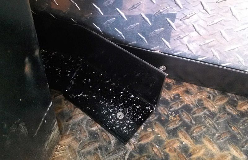

Got some angle, drilled it out, countersunk holes for obvious, later, reasons, painted it.
Had to get a mock up for the corners.. grabbed a handy set of saw horses and..
Temporarily screwed them on..
And tacked the corners.. Then welded them up. Three sides is all I needed.
Then attached them;
I later caulked the upper edge...keeps debris out and looks cleaner. I'm a Sika fan for those detailed interested.
I changed out the angle on the flatbed for something a bit taller, and I tightened up the tolerance between them. Screwed them down;
