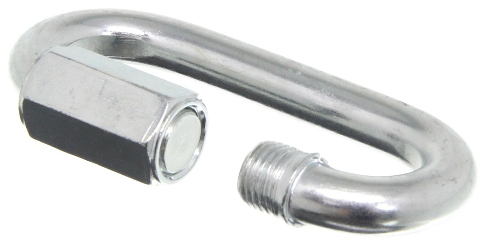

I posted earlier that the clevis hooks on the safety chains of my new trailer are a BEAST to connect / disconnect from my F150, so I want to either swap them out for S-hooks, or find a heavy duty bracket of some sort that I can attach to the frame of my truck which will serve as a quick connect for the clevis hooks.
If I decide to replace the Clevis hooks with S-hooks, I'm going to have to add an extra quick link in order to attach the S-hook. I'll of course choose parts rated higher than the GVWR of my trailer, but I'm wondering if adding an extra link to the chain is going to make them too long? I wouldn't think that only one extra link would matter much, but you never know.

  • I preferred the quick links. Also put a link on the truck for easier reach.
    If the chain is too long... remove a link is better than a twist.
    Clevis hook is awkward at best. JMHO.
  • Reguardless of what you decide for attaching your hooks, I'd refrain from twisting the chain to take up slack. If you ever need the chain to do it's intended job, twisting can potentially weaken it. I'm not understanding how the chains can be too long and that's a problem. cut a link out if they're too long. Use these if they're too short. Although, probably cheaper to just buy a longer chain!
