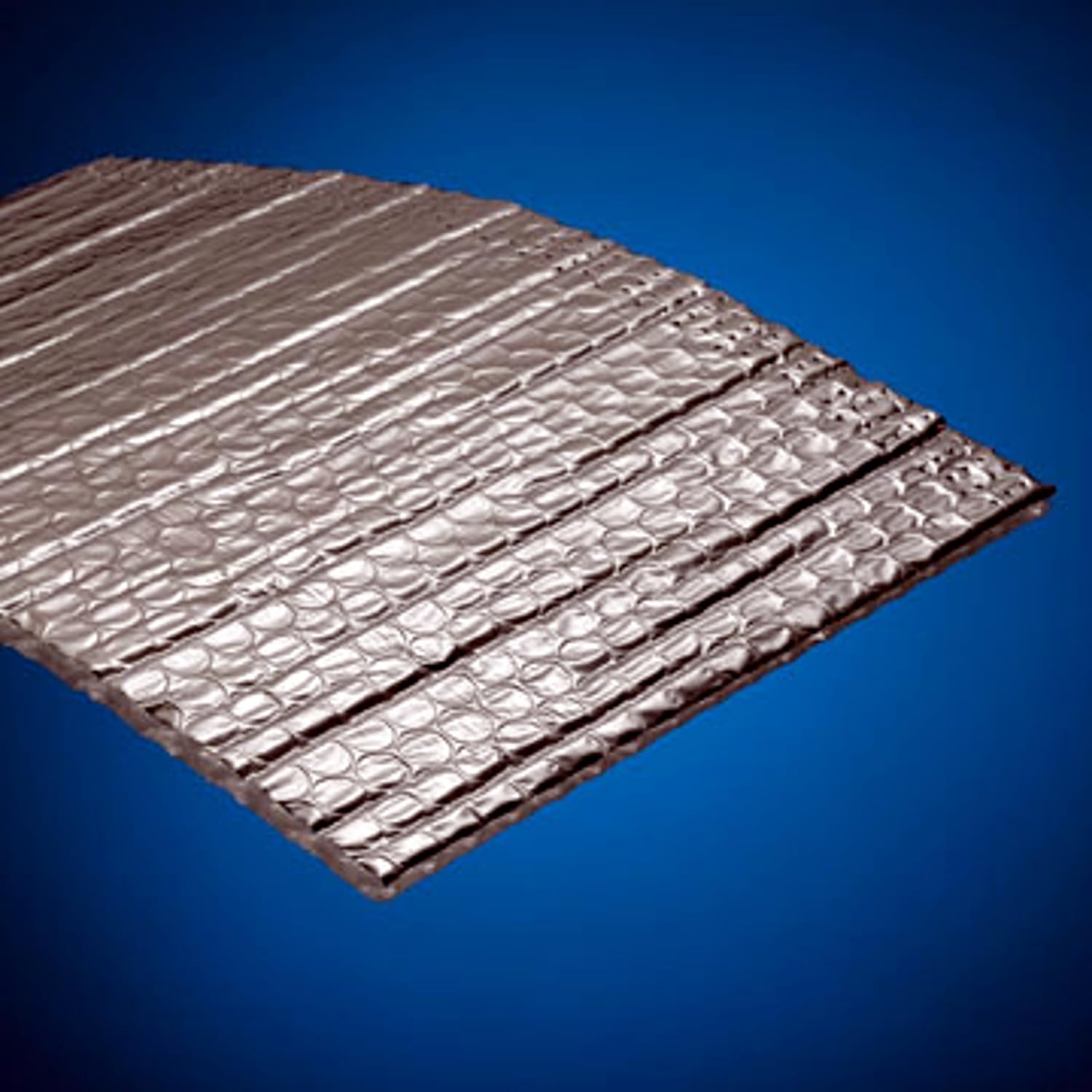

If you don't care about light or seeing though window, folks have used "reflectix" which is a thin aluminum foil backed insulation that has tiny bubbles like bubble packing in between the layers..
Looks like this..
Folks like it because it has about R3.7 insulation value in a very thin insulation.
