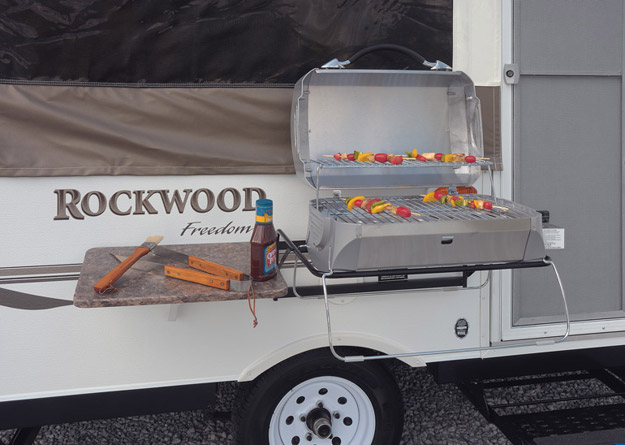

Exterior camping stove instead original Exterior Grill?
My pop-up model came with Exterior Grill, which can be attached to the outside wall and plug to a propane hose.
I never used the grill so I gave it to my brother (he was very excited).
Is there any way that I could plug my Coleman camping Stove instead?
(that will be VERY useful to me)
Thanks
Here it is:

    Thanks to you I have learned that the Pop-up has low pressure propane system (at 11psi), while the Colman is using a high pressure (at 16psi).
    I have decide not to do anything, and just keep it the way it is as the 1# green propane bottle usually last me a few camping trips anyway,
    and the price of the hardware will never justify the hassle.
    Also I will be safer that way too.

  • The Coleman stove you have, has the PerfectFlow™ system.
    Meaning propane pressure regulated. That's the part connected to the bottle.
    Eliminate the bottle & the connector to the stove. Have a propane supply company make up a hose with the correct fittings for both the trailer side & stove
  • Ok the grill you gave away had a gas input that was after the pressure regulator. So low pressure input . The grill in the picture goes right from the bottle into the grill. So high pressure input. Will not work.
    Buy a grill that uses a big bottle and pressure regulator. Or use what you have with the little bottles.
