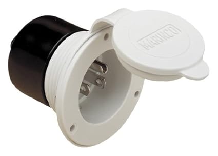

Without seeing a photo, the first thing that comes to mind is adding a 120 volt 15 amp power inlet like in the left photo below. You would get a piece of white 1/8" HDPE and cut it in an outer and inner circle. Mount the inlet onto the round piece of HDPE and screw it on and caulk it. I did this with a 30 amp inlet as in the photo and it looked factory original. I used a small cutting board made from HDPE that I got from a dollar store. You could cut the HDPE in a circle in a size to suit the damaged area.
