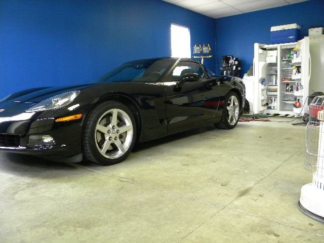

Where did I say that it shifts under 2500 with heavy throttle? I said it does it and I'm not putting around. There is not really any place to legally "put my foot in it". Yes I do own one and if you need proof just tell me how you want me to give it. Cold hard facts! I know that's what you want. I can take a picture of when I hit the Start button it comes across the dash "Gary's Corvette". It's a 2005 LS2 with 4 speed auto, 3.73:1. It has 400 hp and 400 lb/ft and weighs right at 3500 pounds. Need a picture too?
On another note, have fun camping and be safe out there! Oh yeah, I hope you can get a good tail wind going and coming too. LOL!
Thanks! Beautiful Corvette. 400hp and 400ft/lbs with a 3.73 would make a helluva tow vehicle engine for me.

transamz9 wrote:
Hannibal wrote:
I agree with you 4x4ord but what's wrong with a gas engine running 3200rpm? Back before O/D was implemented not for towing or the faint of heart but instead for CAFE requirements, we used to run 3k~ rpm or more everywhere we went on the interstates. 3k rpm is nothing for those run forever 4cyl Hondas and Toyotas. My '98 12v 5spd/4.10 Cummins used to run 2500rpm at 70mph towing or not. 74mph was against the governor and that was all it could do. Didn't and won't hurt a thing. Higher rpm puts less stress on the engine, not more. Turbo chargers force more air into the engine increasing the compression ratio which makes more torque. That's a good thing. They also allow rpmaphobes to lug their engines when higher rpm would be better for the engine.
IDK how you figure we are "Lugging" or engines. For one, an auto transmission will not let it lug. At 74 MPH my little car engine is running 2000 RPM and I'm sure the new one are running less than that. My Cummins has been well over 100MPH and your old '95 would have too if tuned to do so. I think you need to go take you some rides in the new diesels but be careful, you might just have to walk out without your old gasser.

RPM does not scare me what's so ever and have no problem doing it when it's needed to do what I want to do. When I say that my car shifts at that RPM, it is not loafing by no means. Loafing it shifts at about 12-1400 just like my truck does. I'm not "irrational" about this I just know what I like in a tow vehicle. I drive a lot of trucks day in and day out and usually towing something or at least loaded. I will tell you this. Using all of the RPM your truck has to offer to make it to the top of the hill does not always give you the best results.
As far as the 454 remark, you know what I'm talking about. It was a towing machine compared to the other options in the same years. OH! I forget, you are one of those that like to come apples to oranges just like the post right above this one where you say that your little ole 5.4 will run circles around you "1995" turbo Cummins. So I guess your little ole 5.4 would run circles around my 2005 Cummins also. LOL! Dream on!
OH, BTW thanks for the English lesson, you really look smarter to me now.
If you're Corvette (if you really have one) shifts below 2500rpm under heavy throttle, something is wrong with it.
On another note, have fun camping and be safe out there! Oh yeah, I hope you can get a good tail wind going and coming too. LOL! - transamz9Explorer
