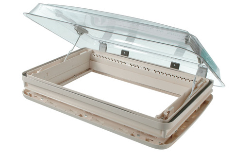

Heki midi skylight broken,,
If I ever meet the man that designed this unit I will spend some time behind bars. lol
From day one we have had issues with the latches and finally they broke and also broke two of the hinges holding the front down.
I cant justify spending $700 for a new one and need some ideas on how to close it permanently.
Im going to first remove the gas shocks but not sure what to do after this.
The white tabs on the inside snapped off also..

    The collar of the frame looks like it sticks up enough to easily screw into the side of the frame and not the roof. I'd still cover the edges and the screws with a piece of 4" eternabond. Think a couple inches in the vertical and a couple inches on the horizontal. That should be bulletproof for leaks.

    Is this the unit?
    If this is possible, I'd add screws around the lip of the lid and then flash / seal the entire perimeter with eternabond. It will still look like a perfectly good fixed skylight and not leak wind or water.
    Im just scared to put holes in the roof of the camper.
    I was thinking about drilling into the sides and install some very small S.S bolts and then taping the sides. I would need to be careful not to over tighten them..

  • Is this the unit?
