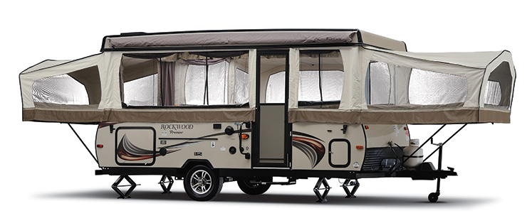

If the BLACK and WHITE cables are the same slightly size then those are the main battery cables. You should be able to hand trace the WHITE CABLE back to a main trailer frame connection near the battery terminals... The BLACK CABLE should go all the way back to the CONVERTER CHASSIS which is probably an ELIXIR model. I need to look at some 1989 ROCKWOOD interior photos to see what is mounted in the cabinets. If I had the model number hopefully I can find similar photos of your trailer on the internet to look at.

Pass along the model number of your 1989 POPUP... Depending how big it is will determine if it has electric brakes and what is installed inside... All the 12VDC items inside will run from the CONVERTER when plugged into shore power or from the BATTERY if you had one.
