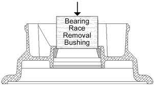

JRscooby wrote:time2roll wrote:
The artist missed the fact the shape of hub will not let anything vertical reach the race. Driving them out, always working at angle.
OP, you might cut a bar the right length to lay on the race, then push the center.
Big races, with alloy hubs, where I fear the impact might distort the hub, I have just ran a bead in center of face. The weld will pull the race, let it just slide out.
Good idea about a bar across the race.....I'm thinking some 1/4" flat bar that is arced to fit race arc and just shy of the full width (there isn't much room between race and sides of drum....probably thousandths of an inch) of the race so doesn't scrape on sides of hub yet still fully catches race edge.
Thoughts?
