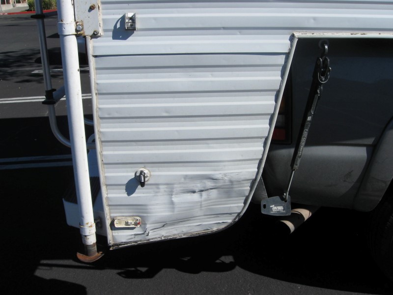

I should have checked my computer before posting. Four years ago I took my rig to the factory for some dry rot repair. I remembered I had pictures of the areas needing repair. One area repaired was the same wing that got crunched. I now know exactly what it looks like beneath the siding. :)

Give them a call to start. - monkey44Nomad IISame problem with skirts on my '08 845 ... the interior of the wing was weak and some water intrusion and rot.
I bought a piece of marine 3/4 plywood, cut a new panel to fit each side, drilled it out for lights and water drains. Sealer and paint on both sides and all edges,and installed it (in process now) and will share photos here when finished. Just got some exterior white paint, and good as new with little chance for rot now.
I did notice the caulking was "a little weak" in application all around that area. For the future, I'll post photos later too. I discovered the front jack mounts had some 'give' in them when loading ... so, I welded a bracket that lays alongside the camper wall, and drilled bolted it thru - takes most of the stress off those very tall jacks in front. Now, it's solid, and not the give it had before -- - SteelhogExplorerNot too bad to undertake as a repair. Rather than try and replicate the staples I used a Kreg jig and pocket screws and waterproof glue. Two fun discoveries. 1) the drain petcock has virtually no slack and the hole which looks like it was done with a hammer and box cutter make it very tricky to get the spigot reclamped. 2) on the inside of the wings of my 845 some type of vinyl coated luan was used. Fortunately I was able to gently peel the delaminated luan off the plastic sheet/film.Took a Saturday and part of a Sunday to do both wings. One of the oscillating saw blade multi-tools helps a lot. Good luck.
