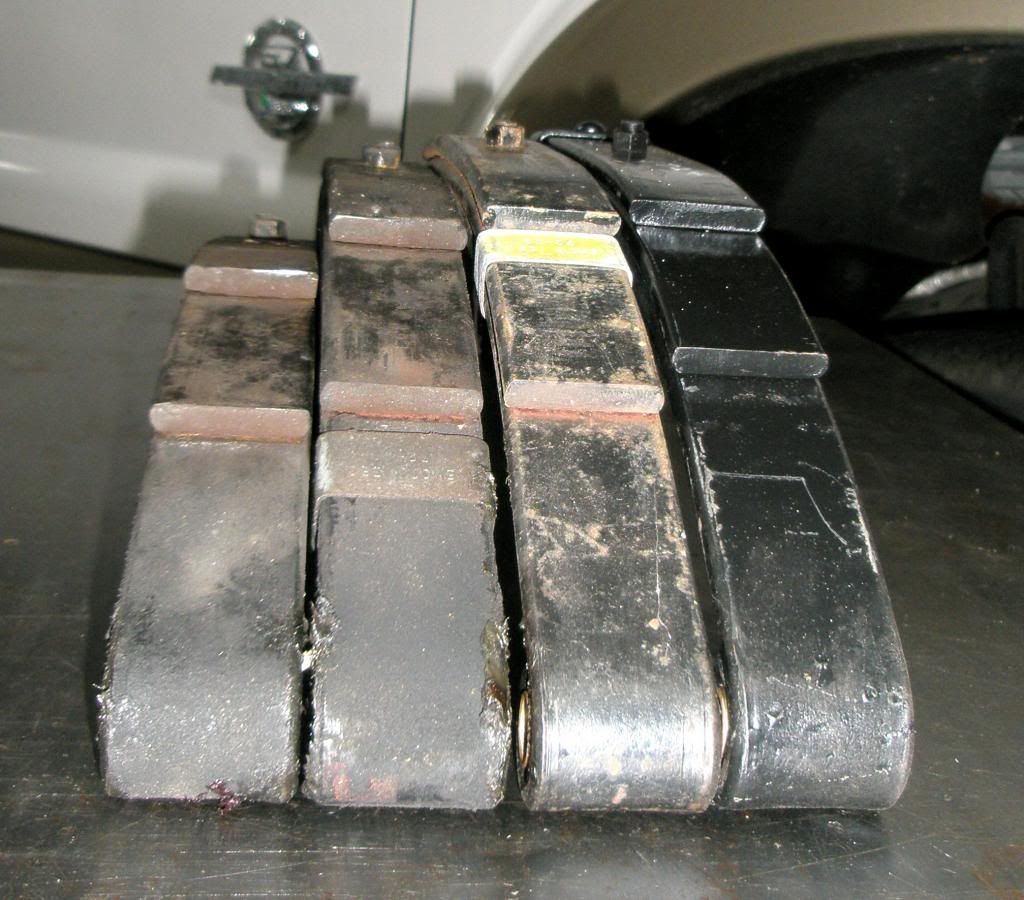

I noticed last season my trailer (2010 KZ Spree 324BHSLX) has sunk a few inches as I have to pull back the fender skirts to install and tighten my wheel chocks. Also, the tops of the tires are about 1" from the inside of the wheel well and both side are the same. I'm not overwieght and None of the springs are broken, but the springs do look to be flattened out a little. I know its a 'super lite' trailer, but there are 3 leaves in each leaf spring. A quick look around my storage facility at similar length/size trailers and any trailer from a 27' up to 35' has 4 leaves in each leaf spring. Local shop has offered to put 4-leave leaf springs on but can't guarantee it will raise it up by any amount. I called KZ and they tell me that the trailer was built with Dexter 4400lb axles and 3-leave leaf springs to keep it lightweight and that installing 4-leave leaf springs may be too stiff and damage other components on the trailer. They suggested calling Dexter. When I called Dexter they asked for the s/n off axles and then they'll be able to make a recommendation. When getting the serial numbers I notice the axles are actually 3500lb Al-Ko. I've called and left a message at Al-Ko, but my question is has anyone else seen/experience this and are axles and leaf spring sets 'matched?' Would it hurt anything if I kept the 3500lb axles and went with 4-leave leaf springs? Thanks in advance.

I don't know about smoke and mirrors.. But there are some factors that determine the ratings.
Bearings have a rating.
Springs have a rating.
Brakes have a rating.
Drums (5,6,or 8 lug) have a rating.
Tires have a rating.
The axle tube, both diameter and wall thickness has a rating.
Building an axle means assembly of all of these parts.. The lowest rated part determines the rating. Sometimes, as I suspect your 2800# rating was for, it is just the springs. Those can be later upgraded to say 3500# springs and viola! you now have a 3500# axle.
My TT came from the factory with 5200 axles. The springs in my case were the limiting factor.
It can be interesting to delve into just what makes up your axle unit to see what determed the rating. Sometimes more capacity is pretty easy to get.
