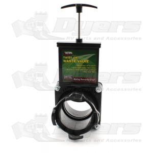

  • One of these works better.
    Just twist it on to the fitting on the end and then put the cap on/off. Hook up the hose and just pull two valves instead of one. No surprises.
