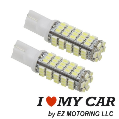

921's in outdoor kitchen..
68-SMD T15 12V LED
#B0096J90KW
Used a bulb with more LEDS.. Same coolness but brighter for the outdoor kitchen!

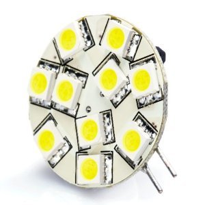

Lastly, the 13 interior puck lights...Type G4 Base. I ordered 1 of each version so I could see them shine inside.. The warm white was an exact match to what was factory installed. The cool white was a huge improvement and was what we liked best.
5050 SMD LED, 170 Lumen COOL WHITE
#B00B4351RO
5050 SMD LED, 140 Lumen WARM WHITE
#B009DRKQ1Y
