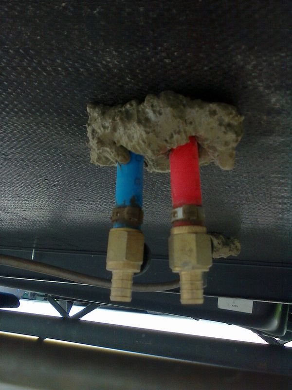

The picture is not my trailer but the low point drains on mine look very similar to these only mine are closer together and have black screw-on caps. Last trip one of mine was leaking so I want to replace them with something more reliable and easier to open and close than a screw on cap. Would Sharkbite ball valves work for something like this or should I stick to something plastic since they are exposed? It would be nice to find something at Lowes or Home Depot so that I could replace them today. Thanks

  • Decided to go with the actual Sharkbite brand at Home Depot. Love how it turned out, no more leaking caps to unscrew.
  • I use Sharkbite like dmullen shows above. Work great.
  • One of my plastic ones was leaking, so replaced it with a similar push on from Lowes. Worked great. I didn't use the ball valve, but many people do. The ball valve just causes the drains to hang a little lower than they normally would due to the slightly longer fitting.

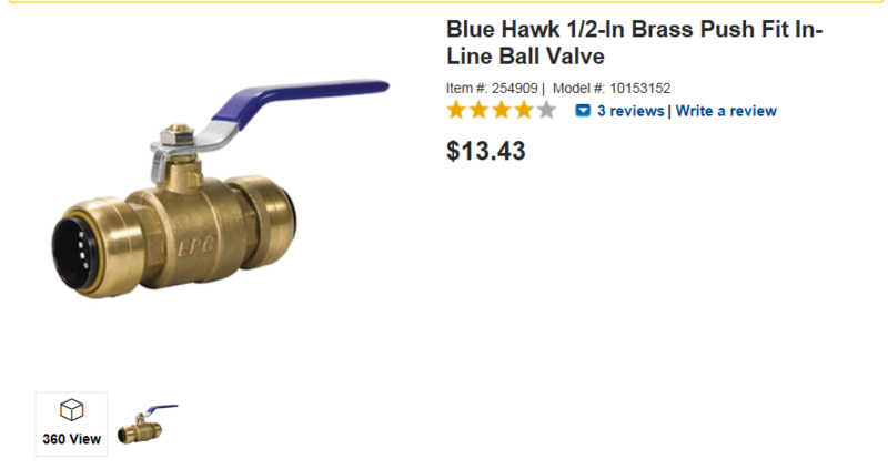

  • So this should work? http://www.lowes.com/pd_254909-2140-10153152___?productId=50067747&pl=1&Ntt=ball+valve
