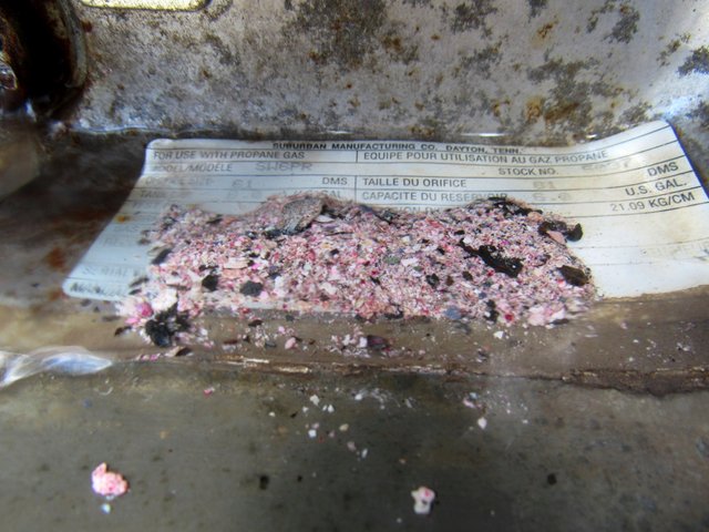

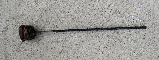

When I bought the camper here's the anode rod I took out and all the junk that I flushed out of the water heater. I knew it was going to be short lived. :(

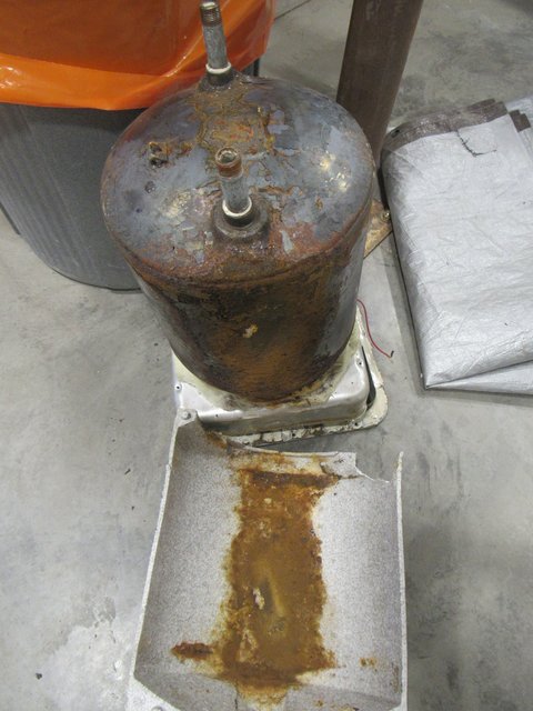

It finally started leaking a bit while I was camping. It only dropped when the pump was on.
Looks like its been seeping for a long time.

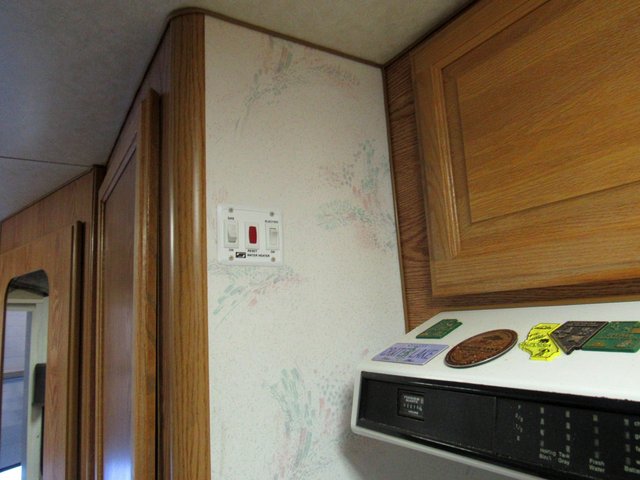

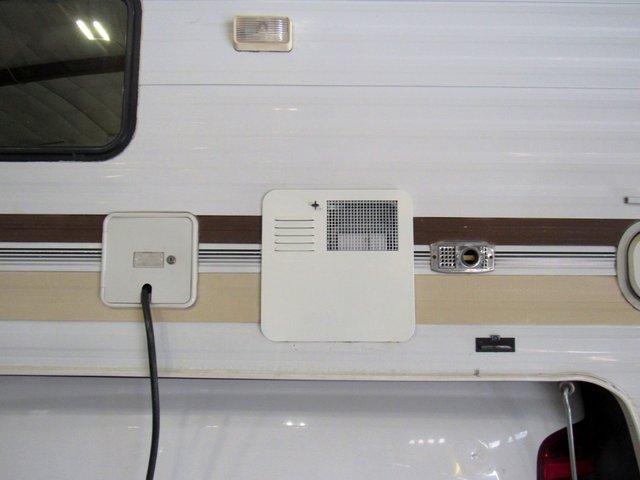

The new water heater is a 3-way. I didn't bother to hook up the 110v side.
I was always surprised that my camper didn't come with a water heater that you could start from the inside. Another happy addition.
