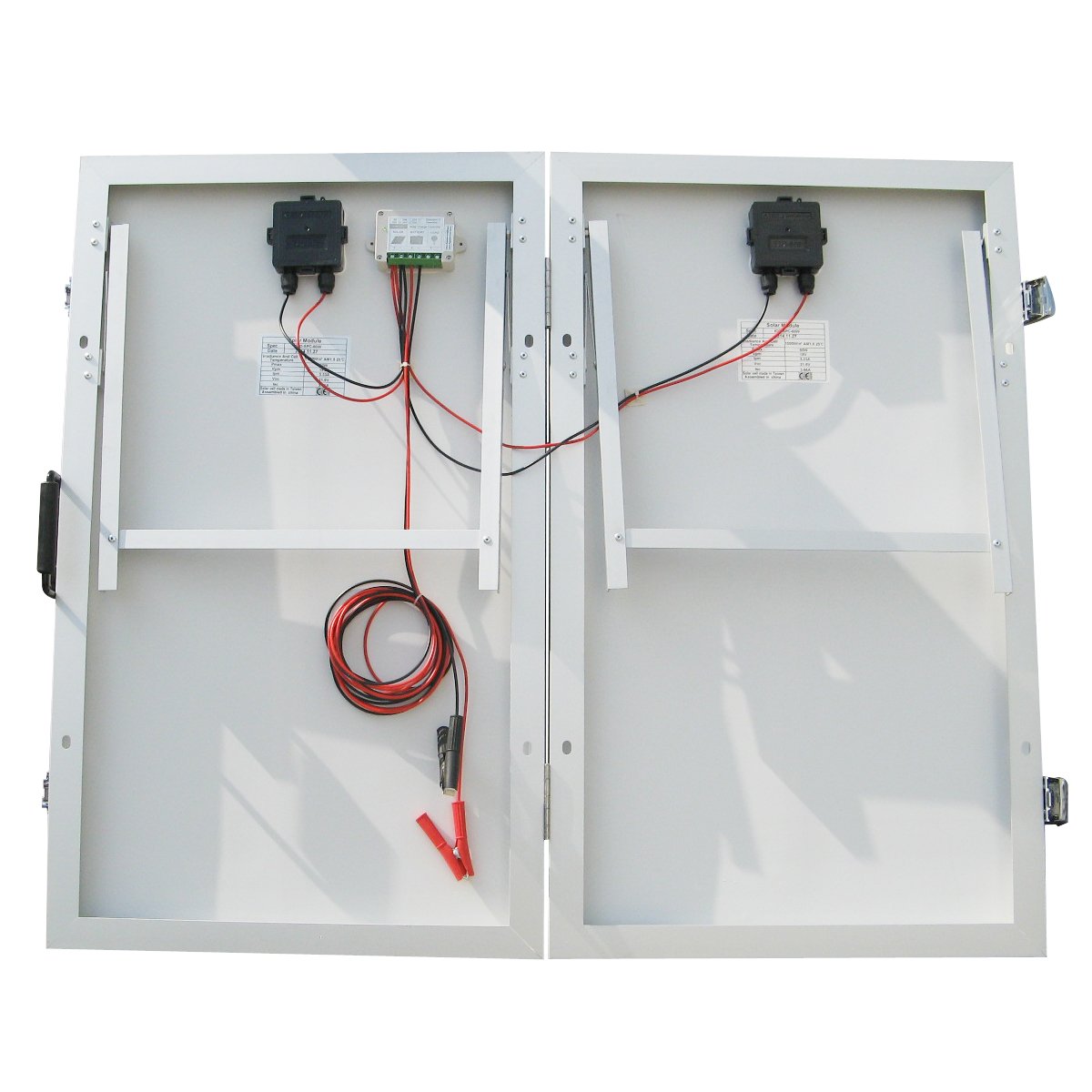

  • Having the charge controller at the solar module is certainly not an optimal design and you might want to consider moving it close to the battery if you have to replace it.
  • Johnnybgood wrote:
    Thanks for the info. I will have to get on the roof and look for it. I don't have a red light under the sink.
    It may be mounted under the solar panel and hard to see. Like this.
    I would try removing the battery and testing the battery cables with a multimeter on a sunny day with the panel covered and uncovered to see if there is any charging going on.
    After so many years this factory option may have run it's useful course.
