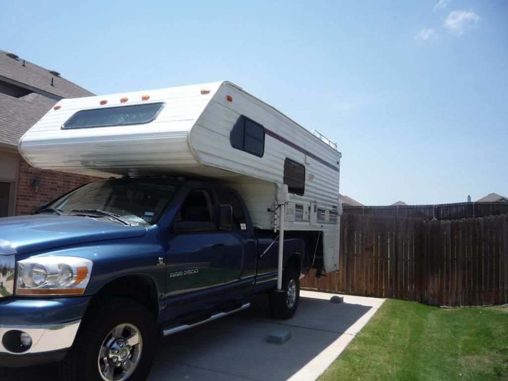

- billyray50ExplorerI emailed Alcoa and never got a response with codes on rims and researched the 17 x 8 forged aluminum wheels that were in original upgrade package on the lot. Some folks on cummins and dodge forums thought they were rated at least 3400 lbs. Alcoa who supplied some Dodge trucks like the power wagons were rated at 3750lbs. I could not confirm this so i upgraded to 19.5 visions rated at 4500 lbs.
Already completed a 2300 mile trip with previous set up with Nitto 285 Durras and 17 " forged aluminum wheels and this size camper with no problems at all. Sometimes forgot it was on there with my truck. Only problem was I could not find out the wheel rating on the 17" wheels. Hence the 19.5 upgrade. Hauled a heavy 11' shadow cruiser for 2 years with only 17" wheels and Nitto terra 285/70/17 tires. NO SWEAT!! LOL and not much difference with you hauling a Lance 1071!!!!! - billyray50Explorer

It is really a 1 ton. Only difference between a 2500 and 3500 3rd generation Dodge is a sway bar and top overload. Installed extra leaf spring in each rear pack, 1 ton Helwig sway bar, Ride rite 5000 air bags and Bilstein shocks. - BedlamModeratorI see some resemblance to mine:
- billyray50ExplorerThey sing a little bit but nothing to complain about really. The added support, improved handling and peace of mind with my 1998 Lance 990 legend which is 11' 3" model and wet weight of 3900 pounds let alone not having DW and granddaughter and more stuff was the deciding factor. Will post pics of Truck and TC tomorrow.
