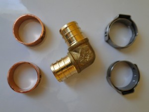

  • PEX Stainless Steel Clamp rings........raised section on ring that gets 'Pinched'. Clamp tool can be used on various sizes of clamps
    Copper crimp ring uses a specific size tool for each size of crimp rings
    Seen both at Lowes

  • Are you certain those stainless fittings are PEX crimp rings? I've never seen them in stainless. I'd be guessing that the crimp connectors are a different standard than PEX. Your braided hose is NSF 61--certified good for potable water, made by Camco, and the abbreviation FWH = fresh water hose.
    As was mentioned, the Sharkbite fittings, although expensive, fit a variety of different pipes.

  • Sounds like the PEX crimp tool was not used correctly by installer so I would be suspect of other fittings/crimps failing
    Using a barbed fitting and hose clamp on PEX will also result in leaks...PEX is too stiff to be compressed around barb fitting by hose clamp to properly seal.
    Go to hardware store
    Get PEX cutter tool
    Get some 1/2" PEX fittings.......Sharkbite (Home Depot)/Gatorbite (Lowes) work VERY well but are expensive
    FlairIT fittings work well
    Sea Tech (by Watts) are ones I prefer.
    PEX has to be cut clean, straight, no burrs
    Might need a length of PEX incase line is too short after cutting to get rid of crimps.
    You can use a Dremel Tool with cut off wheel to cut across crimp......or fine tooth hacksaw. Just cut across crimp enough to weaken then use pliers to remove. Don't cut into PEX
    Personally I just cut PEX into and redo the whole works vs trying to cut crimps off
