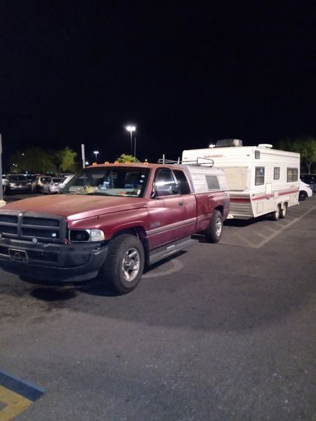

I have a 89 22 ft Layton by skyline
What I'm looking for is the empty gvw and the cargo capacity  and  tongue weight . I have looked on skyline's site , no help at all.
There's tags on the frame from the frame manufacturer and Skyline but no GVW , cargo capacity or T/W
Any help is appreciated
Picture below shows my rig

    Sorry for the tardy response but I thank y'all for the information and every comment brought me to the information that I was looking for axles are 3500# rated so that's 7000 lbs tires are 205 75 15 ld range d   tow vehicle is 95 RAM 2500 Cummins 8800# gvw with 18,800 Gross tow capacity  during our travels I got a chance to run it non cat scales i had  1000# in the bed  TW was 489 total was 12,300 lbs  so I'm right around 5000 lds

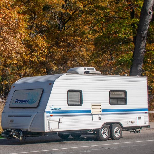

  • For what it is worth, I have a 1996 Fleetwood Prowler 22LU (dual axle) that has a similar look and vintage to your trailer. They call it a 22 ft trailer, although the slanted front makes it a bit ambiguous where you should measure to. The sticker on the side is fading (VIN almost gone) but I recently documented it all for future reference before it is all gone. I have upgraded from B load range to D load range.  But this info might give you a rough idea:
    Trailer GVWR 5200 lbs
    Original Tires ST 205/75R14B @ 35 PSI cold
    Currently Using ST 205/75R14 Load range D   Carlisle @ 40 PSI cold
    Original Rims  14x5.5
