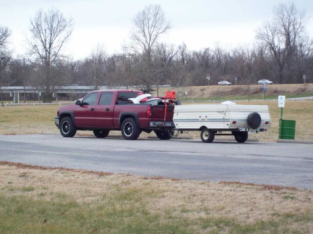

    I can get around 17 mpg on the road solo if I keep it under 65 mph. 75 mph gets me 15 mpg. Towing like the pic under 65 mph is 12-13 mpg. I'm running 285/65-18 tires.
