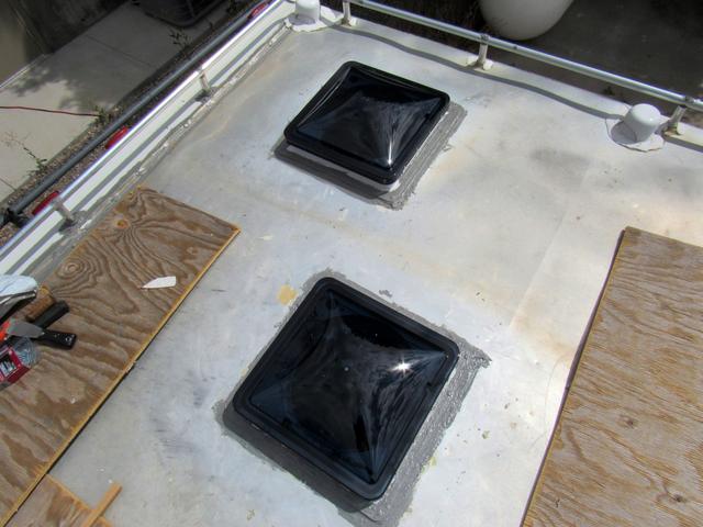

  • I recently replaced both vents with Fan Tastic vents with 3-speed fans.
    I was told not to walk on the aluminum roof without putting down some planks to spread my weight. There's not as much material under the aluminum as there is under a ribber roof.
    This is what I'm using to seal the edges. Its made for aluminum roofs.
