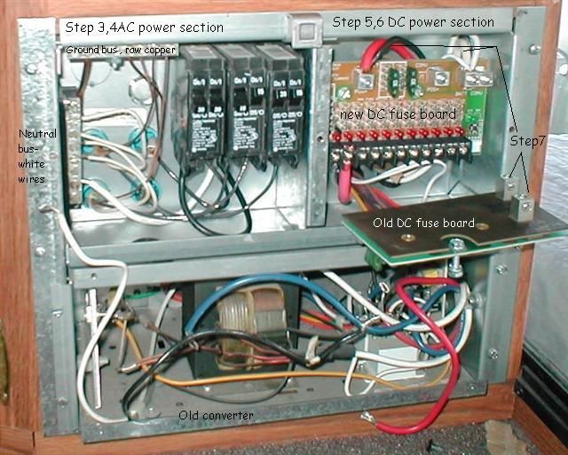

Most of them from that era are covered by a decorative plastic panel which might lead you to believe that it is a heater outlet or radio speaker. - towproExplorerHere is what they look like inside.
you will not see that burnt mark on floor until you remove the charging unit that was in bottom. (and I bet it will be burnt like that)
If yours looks like this, HERE is where you get the replacement charging unit that will fix the problem, and be 100X better for charging your batteries. - handye9Explorer IILook for something that looks similar to this.
