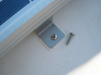

I've used VHB tape for both of my RV solar installations, an Airstream and my Wolf Creek 850 TC. I bought my VHB tape from AM Solar. It's surprising how strong the tape is. All of my solar panel mounting brackets were fastened using both VHB tape, a large screw, and covered with dicor. Cleanliness of the surface before using the tape is essential. The dicor ensures a watertight seal to prevent the tape from working loose from moisture.
VHB tape is also recommended for both aluminum and fiberglass surfaces.
This picture shows how much tape I used and size screw before covering the bracket footing with dicor.
