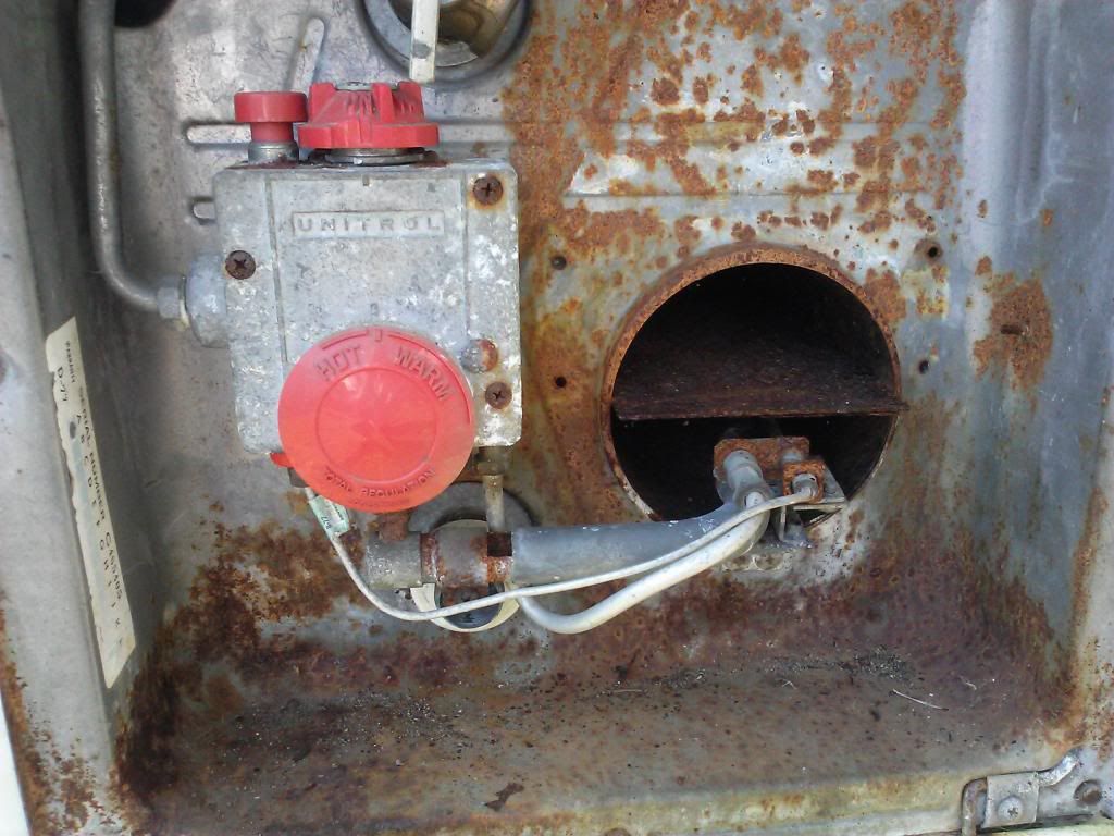

    The last few days I've found that the propane on the stove and oven works...the fridge works via electric. (not sure about propane yet) The windows are in great shape...that's what really attracted me to this project. I picturing sitting in the forward "lounging area" (ha ha....I fancied that up!) and having a nearly 180 degree view. One bad thing that I discovered is that the hot water heater leaks...bad!
