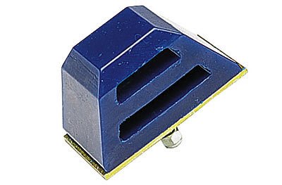

    If Energy Suspension can sell their bump stops for upper overload springs for less than $80 (full set of 4), what extra are you getting when you buy TorkLift StableLoads for $300?

  • Get the overload springs doing some work before making the sway bar determination. You're spot on there. Try with less pressure in bags to simulate installing stable loads. Sitting on the overloads will help sway a bunch. Sway bar will help even more but one thing at a time.

    You do probably need shocks but some movement in wind is going to happen. Use as little Air Bag pressure as you can get by with to ensure the springs are doing most of the work which are progressive.
    Do something to make the overloads engage. There are a lot of different methods if you search here to fill in the space on front and rear overload bump stops.
    I use Energy Suspension bump stops. They are relatively inexpensive and help. I've used these on both my 2006 F350 SRW and now on my 2010 F450 DRW. http://smile.amazon.com/Energy-Suspension-9-9109G-Heavy-Duty/dp/B000CN5GRC?ie=UTF8&psc=1&redirect=true&ref_=oh_aui_search_detailpage
