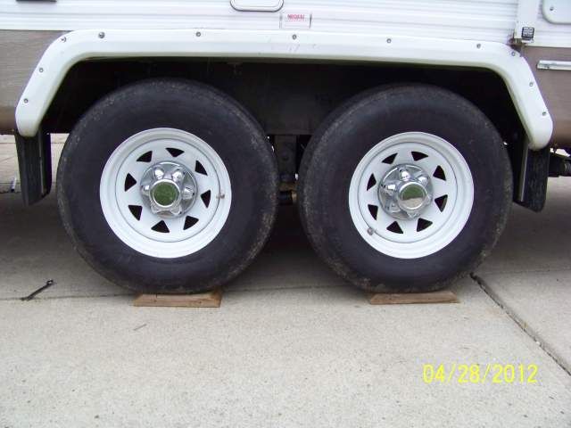

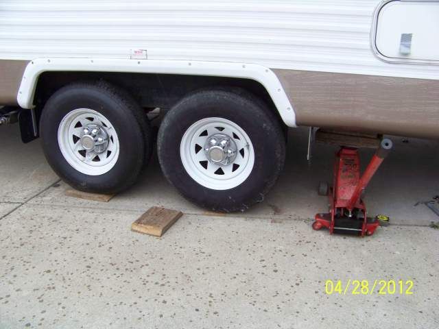

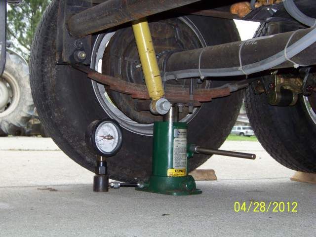

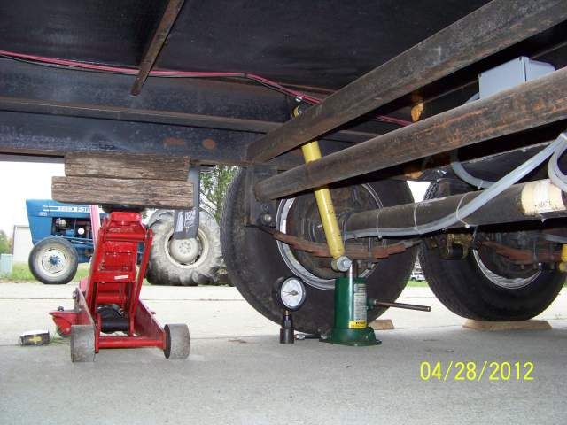

2. If you have a force jack, this is a jack with a fancy pressure gage that reads out directly in pounds. There is a method where you put the camper up on 2 x 8's, then one wheel at a time jack up the camper by the frame, remove the 2 x 8 and let the axle seat down on the force jack which is just under the axle seat, the gage reads out in pounds. Then do some math to get the weight at the wheel to compensate for the axle seat to wheel distance. I have done this, there is some error in it if you have a rubber equalizer. This method can be off ~ 50 to 75#, but I can do it in my yard. If you want more on this let me know.
