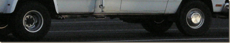

New Exhaust
Now, this I had a shop do. The overall diameter was upgraded on the pipes, all heavy duty stainless steel, high flow twin cats (Can’t get rid of them in Portland, sadly) and a massive high flow twin in and out muffler (about the size of a big beer keg, this thing is massive!).
I had the new twin out exhaust exit just ahead of the passenger side rear tires and the exhaust was rerouted from the driver’s side manifold so that it no longer crossed near the transmission pan.
A ball reservoir had to be relocated off a cross member and onto the inside of a frame rail, but that was the only modification needed to be done to the truck to fit the new custom welded exhaust.
Out of everything, the exhaust replacement made the most noticeable difference in the truck’s performance as the original single cat was pretty much plugged.
One thing also done during the exhaust repairs was to have the hinged flapper valve on the passenger side exhaust manifold welded into the open position as these have a bad habit of eventually rusting to the point where they get stuck closed.

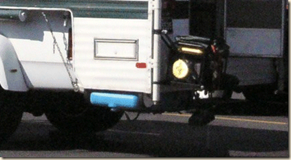

Dedicated mount for Generator
In the past, my little champion generator was carried wrapped in a tarp on the front basket of the truck. While out of the way, it also was a pain to make use of the generator regularly, as it would need to be unpacked and unwrapped then set somewhere and chained in place and a cord run.
Since my plan for this great adventure was to make use of Walmarts and Truck Stops for a lot of my overnight sleep stops, having the generator setup in a permanent mount so I could start it as needed was necessary to save time on having to pack and unpack the generator and it’s security overnight.
So, I had a custom hinged basket made to mount the generator to. The basket is hinged so that when I’m home, I can simply remove the generator and store it in the garage and fold the basket up so that the camper can back up to the deck.
Now, all I had to do to use the generator was loosen the cargo strap and start it up. An extension cord installed to the camper carried the power from the generator to the onboard systems. When I wanted to use shore power, all I had to do was unplug the cord coming from the generator at the camper’s main outlet and plug in my loose cord.
I did have to be careful of the wind when I parked as it needed to be such that it was calm or blowing away from the camper so that I didn’t end up with exhaust being blown back up into the camper when the generator was used, even though the exhaust was directed away from the vehicle.
In the future, I think an extended exhaust pipe will need to be made to help direct the exhaust.
Mounting the 30 gallon portable waste tank for travel
Back in 2009, I obtained a nice 30 gallon barker rolling portable waste tank when I was still doing my full timing at places where there wasn’t sewer hookups for the toilet waste.
Since I moved to the island, the tank hasn’t been used for trips as I didn’t have any place to carry it setup on the camper or truck. If I had had a ladder, this would have been easily solved, but my camper had no ladder and the location where one would have been was now occupied by my air conditioner.
The tank was too big to hang off the back wall without it being the way and too awkward to carry on the forward basket, so I had to come up with an alternative solution.
In the end, I simply mounted six heavy eye screws into the structural timbers along the underside of the camper’s rear overhang so that the waste tank could be strapped upside down against the underside of the camper’s onboard waste tank.
Why upside down? So that it could sit flush, if installed right side up, the connection point for the waste hose and the vent would have been in the way.
The tank was secured in place using three ratcheting cargo straps and stayed put by being wedged there by the hitch extension, the camper’s own overhanging surround and the truck’s bumper, keeping it from being able to shift in any direction.
The fit was fairly tight, very little wiggle room existed, but the tank was successfully mounted in place.
Between the blue rolling waste tank that could be towed behind the truck and the white fresh water tank on the front, it was possible to now stay an extended period of time where full hookups was not available, while using the camper’s faculties as if it was on full hookups.
