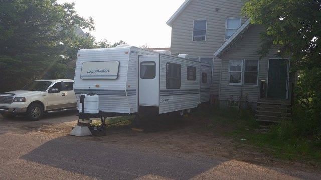

Tire buying advice on recent used purchase
The short of it
The new and almost new tires are 235/75/15 Goodyear Wrangler Radial tires are rated at 2039# each
The other 2 are 225 tires, but have no idea info as I need to replace them before they are road worthy so honestly, didn't really look at info beside the size.
What I just mentioned is how I bought the trailer!
Should I buy 2 more + spare Goodyear 235 light truck tires so I stick with the 235 recommended on the trailer tag?
Or
Do I buy 5 new ST 225 tires (WAY easier to find St225 than 235's)and sell off the 235 Goodyear tires on Craigslist. With this option in mind, should I be buying tires rated for more weight so I can run the recommended 35psi on trailer tag vs max psi on tire to stay near the weight rating?
With a blown tire 1 hour into my first time pulling a travel trailer, I'd like to avoid that again lol. Luckily the 2nd axle tire held till I was off the road.
