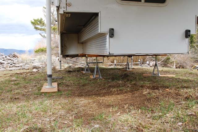

  • We host at a state park in Georgia from time to time. Last time we stayed about 2 months. We live in and out of our unloaded AF 1140. I made up a portable support system that I can easily take with me when we are moving. A couple 2X4s and a few aluminum screw jacks work well. I also incorporated an RV stabilizer for the front. Everything breaks down and stores in the side of the bed of the truck.

  • On level pavement, 12" - 14" is about as low as I can get with the rear bummper and waste drain and I have absolutely no problem camping for weeks at a time with no supports. I just devised a screw jack and beam support on my last trip and there was virtually no wobble. How long is your volunteer stint at the Park?

    You don't even have to do the stabilizers if you don't want to, it just takes out some of the sway that the jacks have. Think about all the TC on dealers lots people go walk around in supported only by the jacks.
