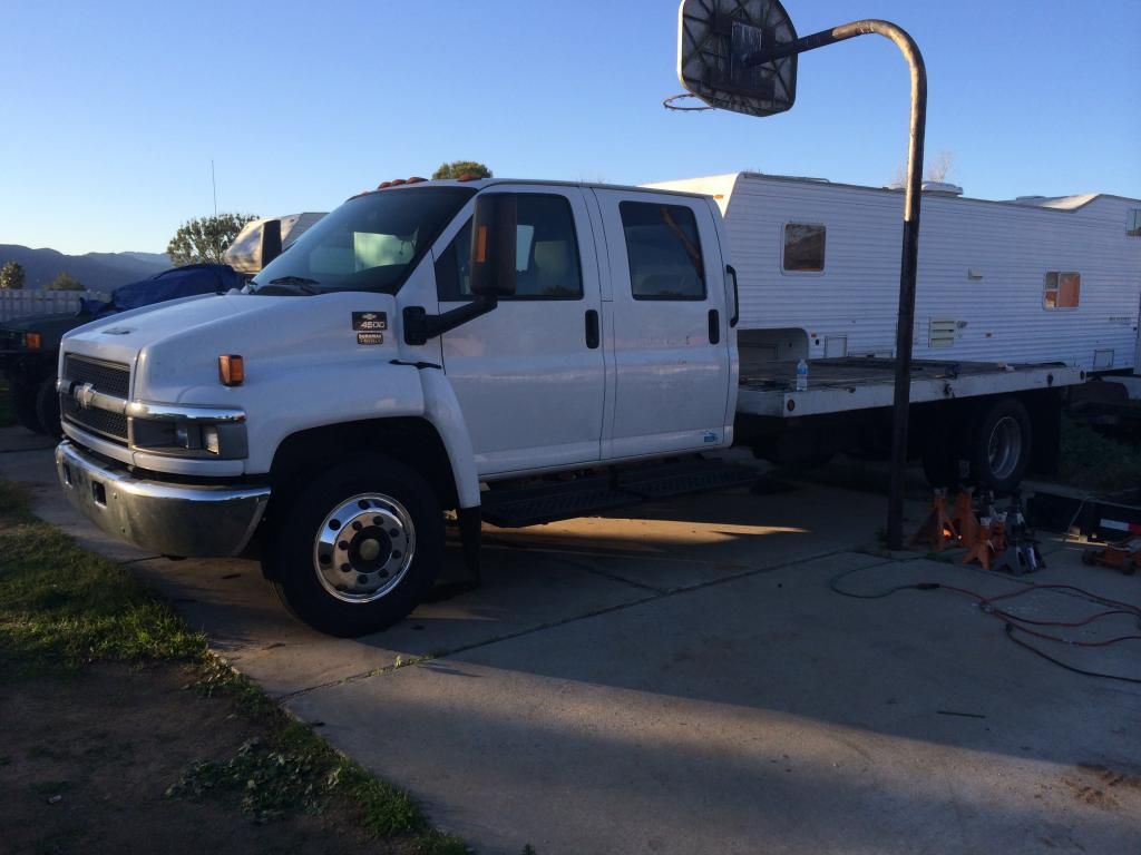

I think I am going to have to lift the truck an inch or two, rear tires are too close to the bed rail in the rear, I'm sure it will sag as soon as I attach the Lance and transfer flow. I'll also be towing a rock crawler that should sag it a little more. I would hate to have to add air bag. - The_Mad_NorskyExplorerProbably a good move taking the company logo off the door.

Finally installed the new wheel and tires (went with 265/70/19.5).
Removed the PO company name from the rear doors… Looks clean now.

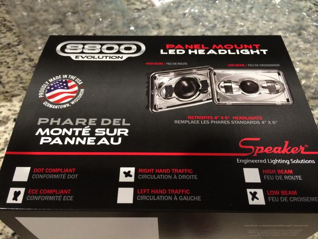

ust received my new headlights (4x6 DOT approved LED headlights… high and low beam).

Right now, I have a short bed Arctic Fox on my 9' deck. I was able to fit 7.5' of its bottom on deck before running into same things you have underneath. My cab is lower, so I did not have cab over clearance problems - I did have to use thick mats to clear my goose neck hardware. - btggraphixExplorerOh yeah, towing. My rig was generally tall enough that I could actually use a really short wxtenaion in most cases. I used about a 20" or so for a long time and the actual ball sat underneath the camper. In the end I had a welder build what I would call a frame extension as it integrates in the Reese hitch but is the same width as the frame, is removable if necessary via a bunch of giant bolts. What that means is I use a short extension of maybe 14" but it is an over-under sort of thing where the upper tube is about 14" above the lower one so I can mount two Mtn Bikes or my dirt bike a over, and still flat tow our Jeep.
Another oddity is that the guy that set my rig up, actually cut off the very end of the frame and chopped off nearly a foot off the flatbed. He did that to keep the camper as far forward as possible. The frame actually extends out further than the flatbed deck does. Not sure if I would have done things exactly like he did but it worked. I might have chopped the deck, but would not likely have chopped the frame. Hell, I extended the frame for the towing for that matter!
I posted some pics of my new hitch setup a couple of years ago but it was on someone else's thread so it might be hard to find and there were also some original pictures from before I made those changes. - btggraphixExplorerSome quick answers....I expect to have wifi the next few nights so will try to get back on and add more.....but with that said:
Length of bed.....the space in front was basically the width of a Honda 3000 plus a little; you might look up the dimensions but Id guess 2.5 or 3 feet. So the bed was probably an 11 footer. I have pictures from when I visited, somewhere.....but not sure where at the moment.
I remember not liking his tie downs a whole lot for some reason but apparently they worked for him. You can see the fronts in the photo above and they go straight down to the bed (no angle at all).
Transfer flow is a great option but only with a 2WD. The comments above about limited range on a 40 gallon stock tank is a good one. I get anywhere from 6 to 10MPG primarily varying based on speed. At 62 I can get 10; at 72 I get more like 7+.
He had a Kelderman Rear Suspension that he really liked, and I ended up going the exact same route and have been really happy. The bag basically replaces the rear shackle but leaves the spring, creating something of a two-stage suspension that really does work. It softened up the big hits a lot on our rig. His front just had an airbag stuck between the spring and the frame and he questioned its value at all and I didn't even consider doing that.
Btw, we did not drive his so I do not know how it rode, but probably very similar to mine. Maybe even smoother on the highway without the front drive axle.
If I had my druthers (and lots of dough) I would replace my rear springs with fresh new ones with more arch from Deaver Springs in SoCal (mine have been seriously worked and should have been the stiffer ones like the 5500 haas. Plus I'd like to change to an eye type spring instead of a slipper, which would require another part from Kelderman to be changed. I'd also replace the fronts with Deaver Springs and new shocks all the way around. But having said that, I am still very happy with how ours rides. Very very little sway when semis go by or in heavy winds so I am very happy with it. I just know the springs are beat and the shocks are probably doing nothing by now. :)
Air bags not needed at all but I was concerned about beating the living crep out of the Lance and wanted to soften up the ride.
All 4x4 4500's are rated for 17500 and the 4x4 5500 is 19500 with the only difference the rear springs. I generally weigh around 18500 without my dirt bike on the hitch. And I am loaded nearly 100% of the time (again why I feel the springs are probably beat)

I have a hide a hitch gooseneck that is under the deck so no interference; you'll have to look at your fiver rails to decide. But note that for my Lance 1191it has to sit on about 3" of plywood (now changed to foam board) to clear the can. There are a number of ways you could claim that space for something like a water tank. You can also put water tank in front of the TC if you leave it auld back and you have a 13' deck.
Good move on cooling system. It is a known issue with all the Durmax's of that range. I have not had any problems but I am very very careful with that and since I went to a new aftermarket tranny (long painful story) it runs hitter than before so I have been thinking about other cooling options especially for the tranny. A couple of aux coolers in the bumper would be nice!
EFI tune probably a good idea. Check out the MDT forum on the dieselplace.com which has some really knowledgable Kodiak/TopKick guys and there are (or were) a couple of other dudes with TC's on them.
I don't really see any issues with your plans....I guess the main one will be the super long deck you have. If your camper sat at normal position you'd have about 5' in front of the camper. There are options, for example rear swing away jacks that would allow you to mount it much further forward but, the bottom of the TC would have to be totally FLAT and many/most are not. My Lance is not and would be major work to make it so. I highly highly recommend considering a side door model to make the entry point low but there's be no way to mount it all the way forward. But having said that, with that long bed of yours you'd just about be able to tuck the TC in behind the cab. Best bet for you might be a short and totally flat rear door TC mounted all the way forward and have a short deck behind on the flatbed. Maybe look at Capt. Eddys F450 threads from a ways back....seems like he sold it but had a nice flat bed setup.
Plenty of options out there. I think I still have the owner of this rigs phone number and if you want to chat sometime let me know. You might also do a serious dive through the old TC on a flatbed thread in the stickies. I was sorry it died but still a great source of ideas.

- 2004 C4500 2wd Crew Cab
- 13.6 foot flat bed with 5th wheel rails and a gooseneck hitch
- Increasing the tire size from the 225 to 265
- Air ride seats (thinking about air ride cab)
- Mild tune for towing only (EFI live)
- Secondary cooling system by Coolertowing.com (My LLY 2500HD overheats all the time)
Plans are to flat tow my trailer and rock crawler to the desert. I currently own a Lance 821 camper but I want to upgrade to either a 1131 or 1181.
Do you foresee any issue with my set/plans.
