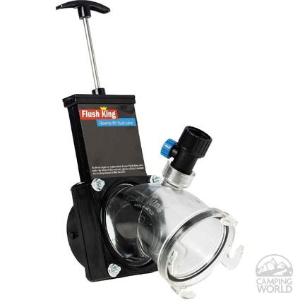

- Mr__CExplorerhttp://www.campingworld.com/shopping/item/flush-king/20522
