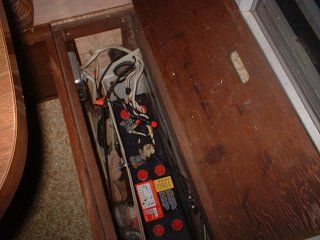

Do you mean charger/invertor or charger/converter ? In any event , mine was the same as 69 Avion , only the charger was under the dinette . I think the original battery was a F3 tractor battery , it was in a plastic box that had the Avion name on it . Here is a picture

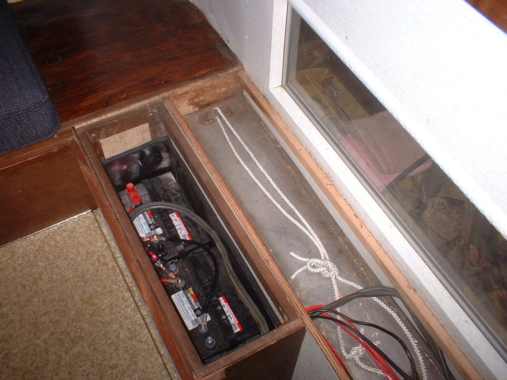

I replaced it with two 24's that I made a sealed ss box for , couldn't find a ready made one the right size . It's tall enough that I can go with two 6v if I want to go that route . I also replaced the charger with an Iota 3 stage convertor/charger . Here's a pic of the new set up.
