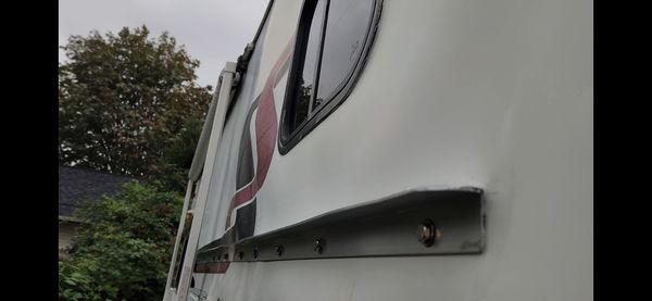

I had to do a temporary framing reinforcement on the Truck Camper Right side cabover. It was getting warping and bubbling in the lower right sidewall so I got some angle aluminium on the inside and outside sandwiching the wall, bolting together with 3"x5/16" SS bolts. Not perfect but better than it was. The outside doubles as a dripedge, keeping water away from that crappy leaking edge trim manufacturers use. It will get us through this travel season.
