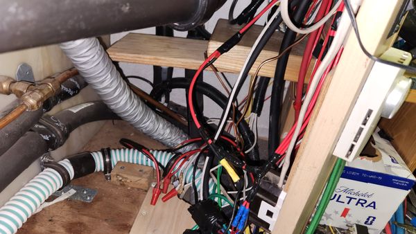

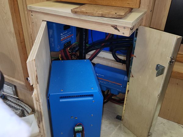

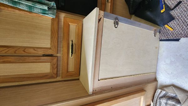

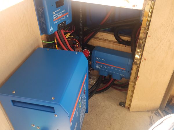

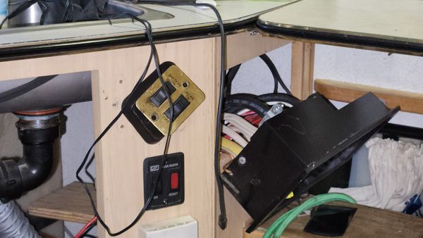

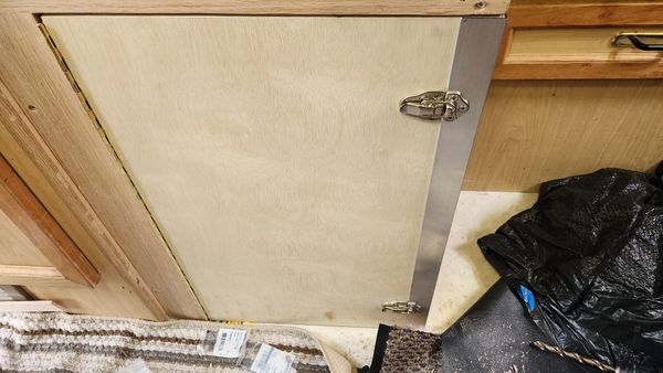

Final fitment. Had to notch door edges for latch bolt fitting. Countertop being held down, I glued it in place using Dicor as adhesive. It will hols, stay in place but if for some reason later on I need to remove the countertop, it will just lift up and off without too much effort. Need to drill 5 holes along bottoms of doors to facilitate ventilation. The inverter has a good fan on the bottom.Countertop on, need to install oak counter edge, and apply wood floor finish. Having the larger counter space will come in handy. It was largely unable beforeThese are the luggage trunk strap locks I used to close the doors and hold them fitting tight together. The corner fits and works together better than expeThis is how the components fitted into the space with adequate room all around each unitPart of the DC rat nestRewiring the DC system, eliminating the 30 amp relay that used to feed the dC system through a 10 gauge wire, reduced to 14 or 16 gauge at the relay. DC works much better now, lights are brighter, jack motors spin faster, water pump spins fadter and water pressure is up. DC system working much better.
