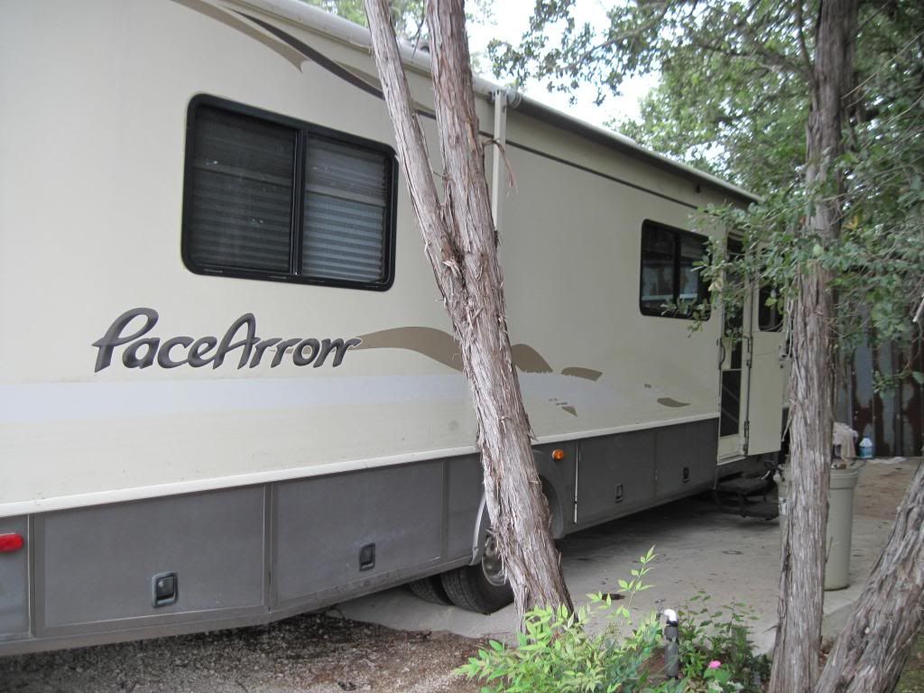

I just finished painting my Pace Arrow....removed the decals like this....Razor blade in a holder to remove decals,Goof off in a spray can and razor blade the remove adhesive....after spraying immediately scrape with the razor blade . Can take off yards at a time. Bast*** of a job..Pace Arrow probably has more ugly decals than any other.
