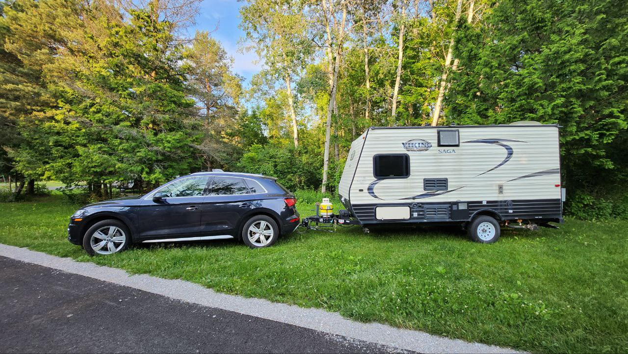

Following Andry's advice from canamrv, I installed the WDH (Weight Distribution Hitch) myself, along with the EAZ-Lift 600 sway control bar, and this combination works flawlessly with my Q5. Andry also assured me that they have installed many WDH systems on similar vehicles. The manufacturer (Audi) covers themselves by stating that it cannot be used, but in practice, it doesn't cause any problems. The front axle only raised by 0.2-0.3 inches. The car drives perfectly as if I don't have a trailer, even in strong crosswinds and at high speeds. Considering my vehicle's short wheelbase, I was expecting worse performance.
The only mistake I made was not raising the hitch ball by 1 inch. It seems that my parking spot has some slopes, and the measured level turned out to be lower in practice. It's too late to change anything now because I airlocked all the bolts on the WDH. However, since the trailer is single-axle, I don't see any issues with this slight forward tilt.
I also weighed my trailer, and it came out to be 2615 lb, with a tongue weight of 435 lb. It's not ideal. I plan to replace my current battery with a lightweight lithium-ion battery to fall within the 15% range. However, even with this slight imbalance, I didn't notice any impact on the ride quality.

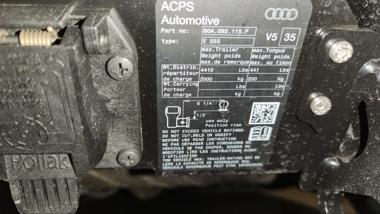

In the previous thread, many people noticed that the OEM Audi hitch receiver specification contradicts the Audi manual, as it only specifies its use with a WDH. I reached out to the dealer for clarification, and after a month and a half, we received a response from Germany. There was indeed a typo on the label, and WDH was not intended, with the values printed in the wrong line of the table. Audi will now issue a recall for this sticker thanks to the vigilance of users on this forum.
