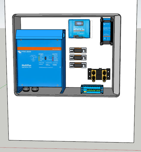

Where do we go from here? Deep breath.. Ok, so now its time for a game plan which I have at least half though out. I need to put the heater back where it was. I also want to build in more counter space since this model of RV is woefully lacking in that department.. And ya know.. If I make that hole in the wall a bit bigger…. Hang on I need to pull up Sketchup and do some thunk'n…
oK, here we go… I did some measuring and counting, I even had to take my shoes off for some of the counting, and I think I got a game plan. If I make a cabinet just a tad deeper then what was there, say 25 inches, I can fit my trash and recycling can under it!
Im liking this so far but wait. I was trying to solve a problem….. OH yeah.. A place for solar stuff!!! Well I got ya covered because if we look at the back side, which will be accessible through that hole in the wall….
BAM! Now that’s what im talking about. And with a mockup of the outside wall with the hatch opening just for effect.
OK ok, I can make this work. Oh, BTW, the side of the cabinet that will face the door will house the breakers, cut off switched and fuse box
