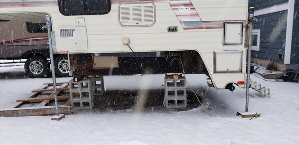

      so what I have now is a 1991 slumber queen and for the battery compartment it is a tiny one outside as no one back then used anything more than a single car battery I guess.  so the small hatch on the top of the back is the battery compartment, but originally when I got it I converted the bottom hatch into a compartment for two 6V batteries, then I had my 280 watt lifepo4 in the top compartment and that's all I could put there.  as for insulating it it wasn't deep enough to add insulation after the battery was in it and behind that is the fiberglass for the shower stall and it isn't a heated bathroom or anything.  and by putting the battery in side in the bottom foot of the closet we gain back both outside compartments as storage.  the top one holds my jack handles a small water hose and my pack of leveling blocks and that is all you can stuff in it.  the bottom one will let me take my outdoor stove and griddle out of the closet and put it in there.  plus it is open to air from the rv, so I don't have to take any other measure to heat the battery and greatly simplifies the wiring.

      if you see the smaller door on the back by the jack head that is the factory battery compartment.  it is big enough to hold a package of the leveling lego's  so 12x12 and about 14" tall so it won't even hold a real battery and that is just a thing fiberglass door skin.  I could insulate that if it was big enough, but then I would have to figure out how to insulate all around it, as it is right up to the wet bath shower wall and the bathroom isn't heated.  when I first got it I put two 6V into the compartment below it.
      so this worked until I built my first battery, and now that I have a new battery built i want to set it up properly inside the conditioned space then I never have to worry about it.
