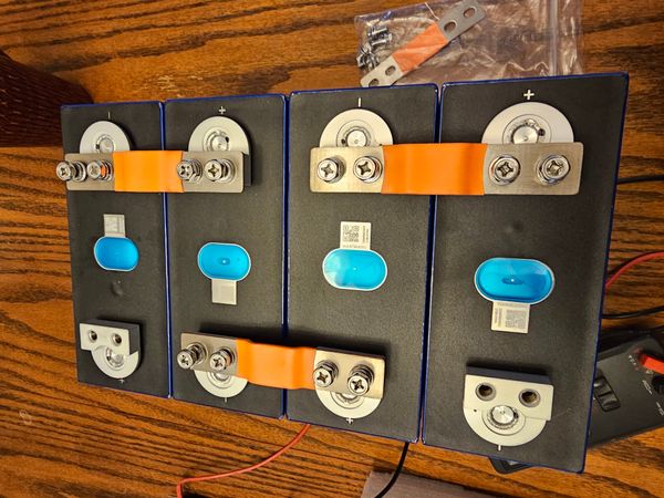

so this started because I gave away my first DIY build (280amp) to a good friend, because I also wanted to upgrade the 5th wheel but standardize the batteries between the 5th and truck camper so I can mix and match depending on my needs.
it started out a long time ago with me getting the cells and top balancing them.  this was a pain as the power supply I have would only do about 8amps at 3.65V so it took around 100 hours to charge and top balance them. For the next three I believe that I will configure them in a 12V, use a 50amp charger to get them right close then rearrange them and do the top balance, should be able to save about 80 or 90 hours haha.    After this everything got put on hold due to some specialty crimps and such I had to order and life got in the way.  But,  thanks for a recent surgery (two weeks ago) I was board and had some free time so it was time to get this rolling again.
original battery pics

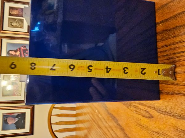

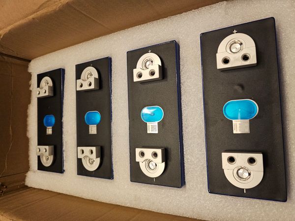

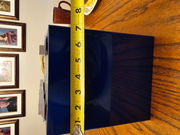

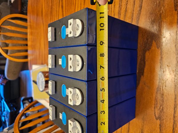

brand new 304AH cells. I picked these ones specifically for the double terminalsso that's how the battery sat for months, the other day I moved it out to the shop and started to get it ready.

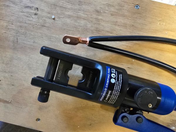

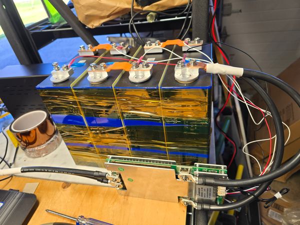

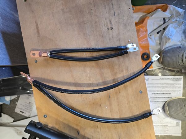

bit of Kapton tape to hold it all togetherhand tool if you plan on making custom wires

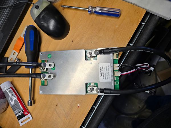

so the terminals on the BMS are rated for 80amps each, so to get the 150amp output from the BMS I had to make 2 to 1 pigtails with 4ga wires which is effectively a 1ga and good for over 300 amps with a less than 1% voltage drop for up to 4.8 feet so plenty for what I needinstalling the pig tails on the BMSbalance wires and main BMS lines hooked up
I now have a working 304AH (well 314AH is what it tested out to) battery just need to build a compression fixture and clean up the wiring a bit.

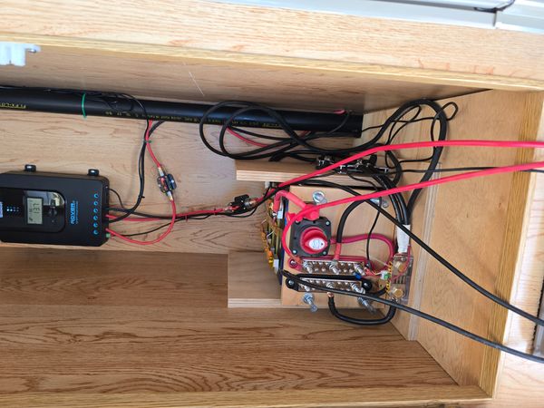

  • well, got a bit more done before it go to hot to work outside.

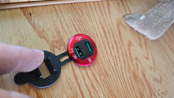

    I had to pull everything out again, as I forgot to run two wires to that area the batteries were in to power my LED backup lights.   I also wanted to put in a USB charger solution so we could charge our phones, and what ever else quickly, and with out having to run 10 foot cords through the sliding window of the truck to a charge port in the truck.  the joys of a 34 year old camper eh.
    I couldn't get it where I wanted, but I found an area that will work.  it is just behind the back of the shelves by about 1/2" so it was a perfect place for it.
    then I proceeded to get everything back in the closet, move the solar controller and clean up some wires.  this morning I am going to start on the shelves in the closet.  by freeing up the outside compartment, I will be able to put my stove and griddle out there instead of in this closet so that is the trade off.  I end up with about the same storage space in this closet but my cooling stuff goes outside.

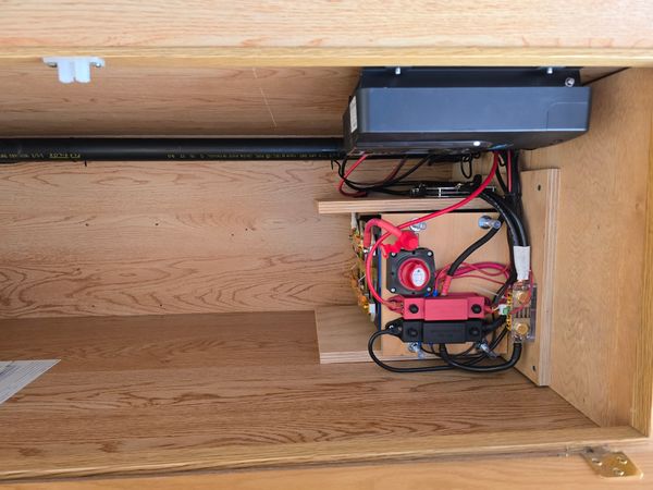

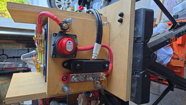

  • I got off my procrastinating butt and wanted to get the camper ready for some fall camping now that the 5th wheel trip is over.  that means I had to get this new battery tested and installed, but first I had to add all the accessories like cut off switch, fuse, busbars and get everything mounted.

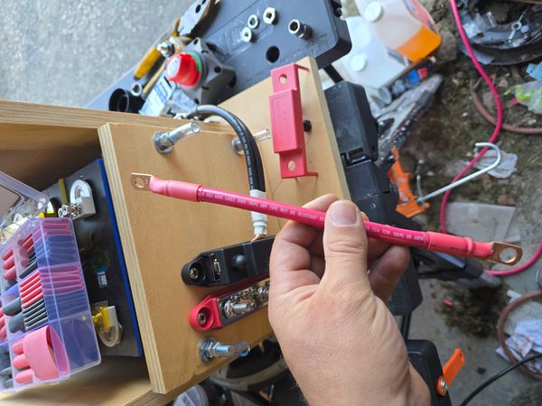

    had to make up a bunch of custom wires.
    First solution, then I realized the shunt for the battery meter was still mounted in the camper
    new mounting solution

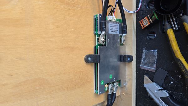

    one of the things I struggled with was finding something around the house to use to mount the BMS.  then I remembered there were rubber feet on the old 5th wheel water pump that might work.  two of them worked perfect and held it more secure than I could imagin
    set in place and temporarily hooked up just to make sure everything is working properly, which was a good thing as I remembered I forgot to run two wires from the new battery location to the old one to power my back up lights.  so once I do that I will move the solar controller to the bottom right hand side, build a cover then a shelf on top  I am still deciding while I am at work this week, if I should cut the battery cables and put new ends on them or if I should coil them and secure then under the base so incase/when I sell it and want to put the 6V batteries back.

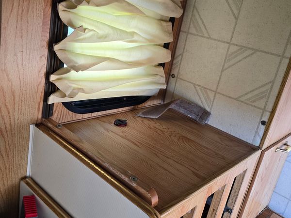

  • so the hard part is deciding how to mount this in the camper.  when I had the two 6V batteries in it they were in a outside storage space, when I built the 280ah lifepo4 I put them in a smaller one that was originally made for a single car battery.  this one I want to move them into an interior closet.
    this is where the new home is going to be. the bottom shelf that covers the furnace will be the base and I will take the bottom 12" of the cabinet and move the solar charge controller down also, so all the power stuff is mounted in the bottom. then I will add shelves as we never use it as a closet, just a place to pile stuff into so I will add a few shelves so we can pile stuff a little neater haha
