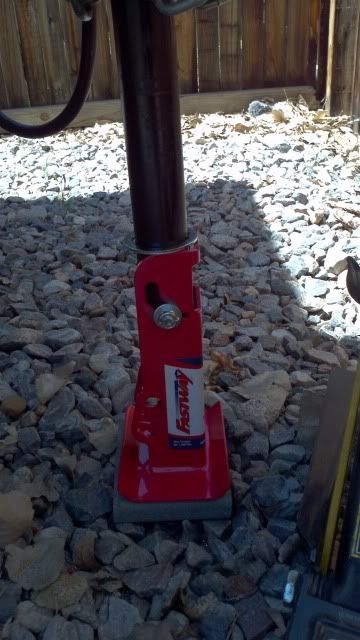

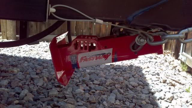

Installed my new jack foot the other day. So far, I like the idea and how it works! Because of clearance issues, I always had to remove the jack foot, but this will save a bit of time.
It's advertised to add 6 inches of travel to the tongue jack. Well, sorta. If you don't use a jack foot (Like is shown in their ads) You WILL get more travel. However, my jack foot is about 6 inches, so it's a wash.
I was a bit concerned that it could "collapse", like a knee bending, but it locks up nice and I even whacked it with a 2x4 to see if it moved. So far so good!
