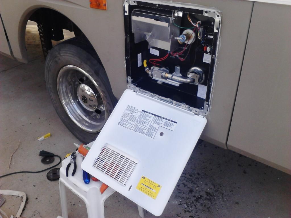

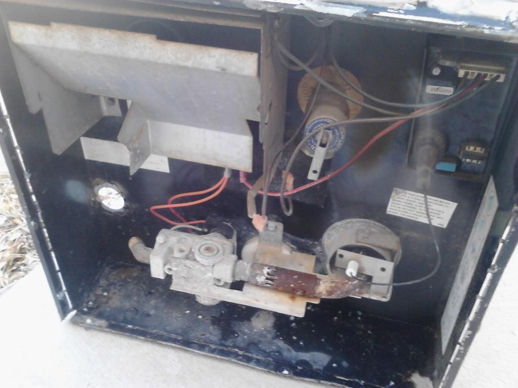

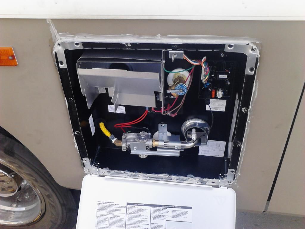

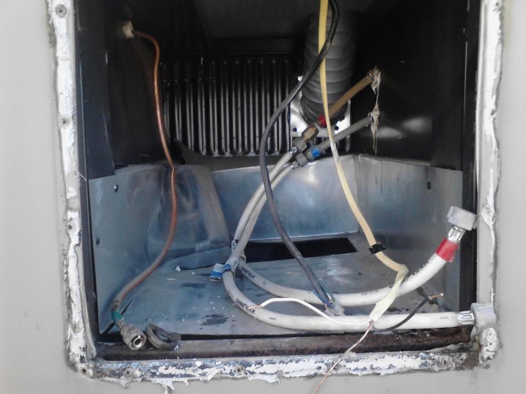

Old water heater: GC10A-3E to GE16EXT. They are both 10 Gallons, ignition controlled, and powered by LP Gas & Electric.

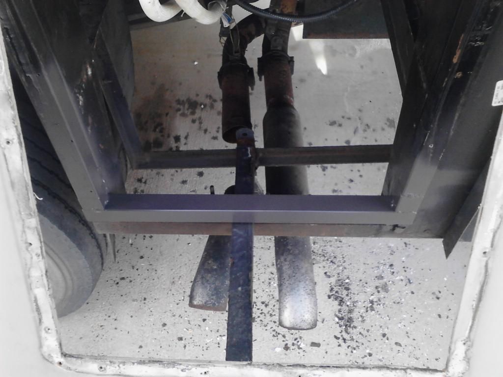

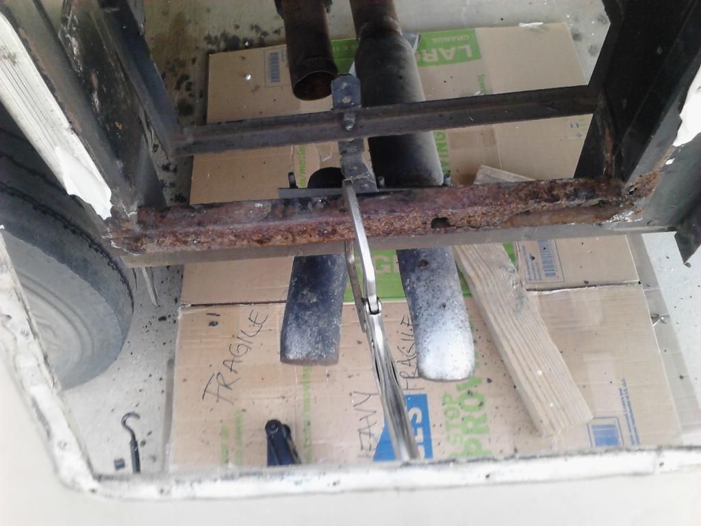

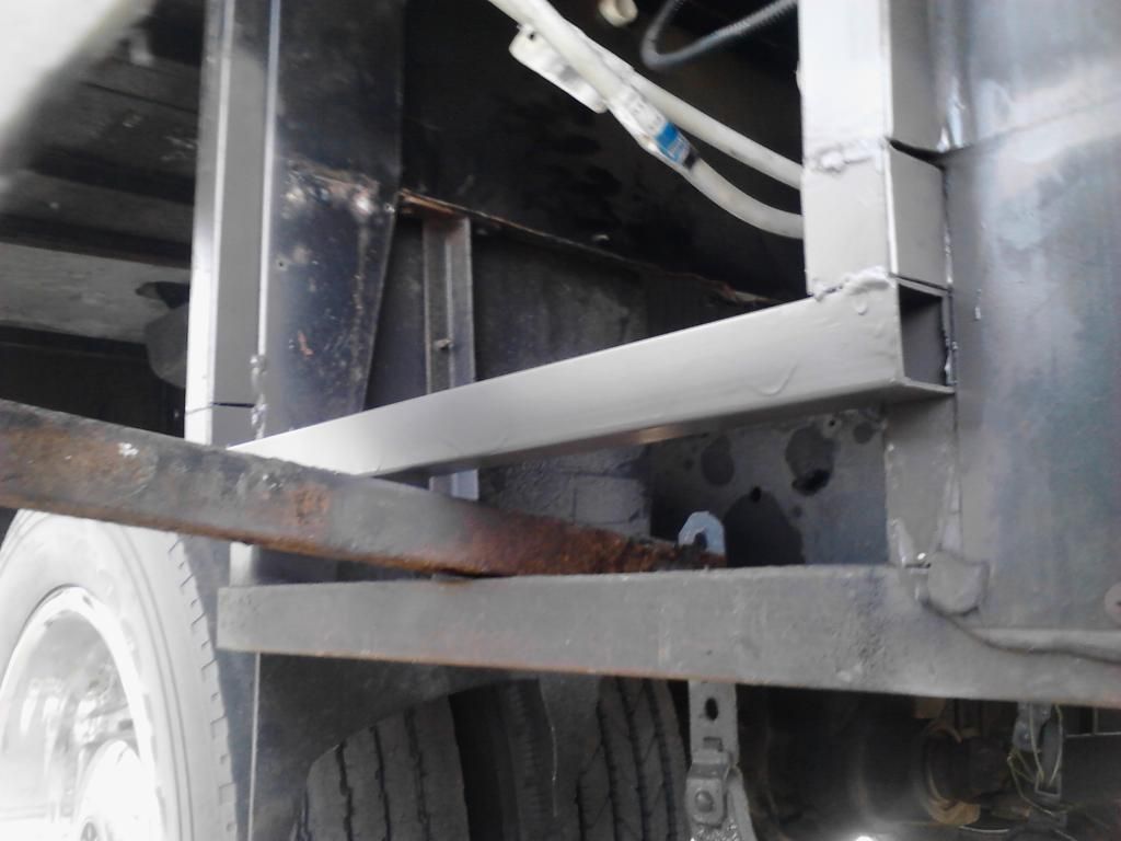

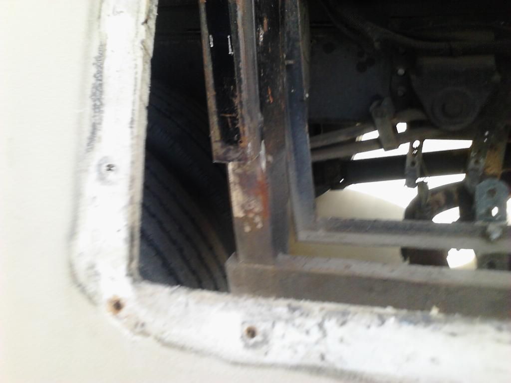

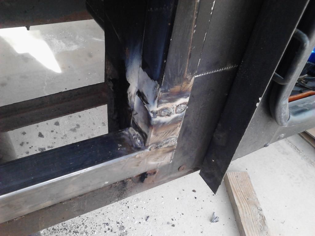

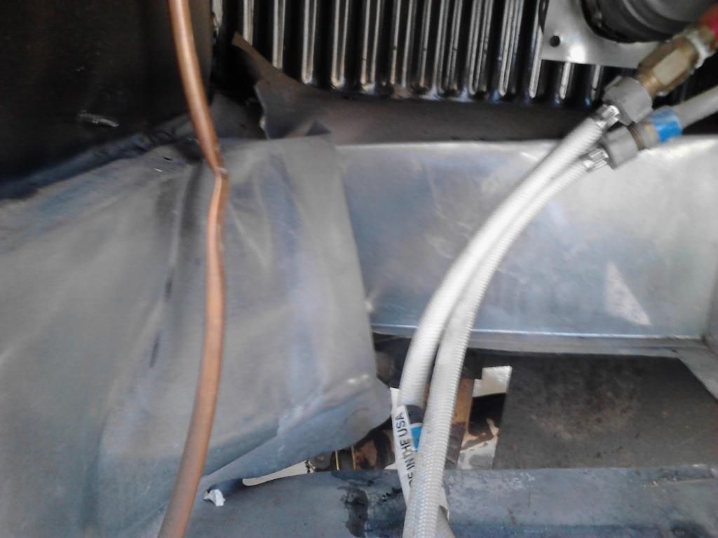

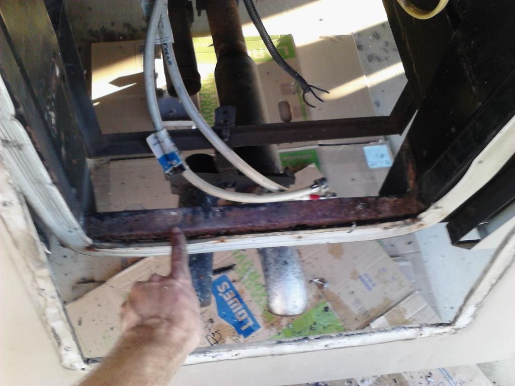

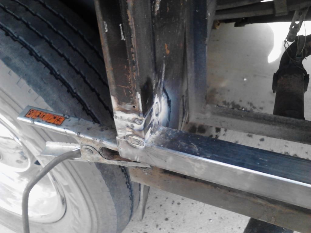

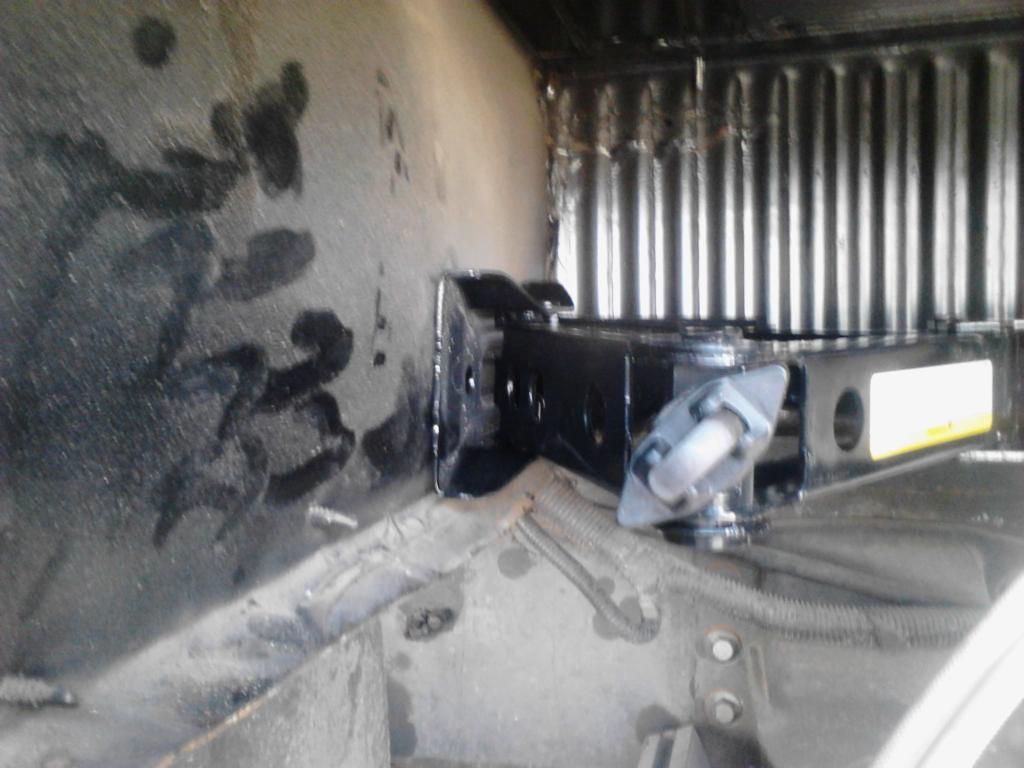

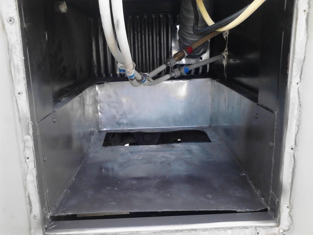

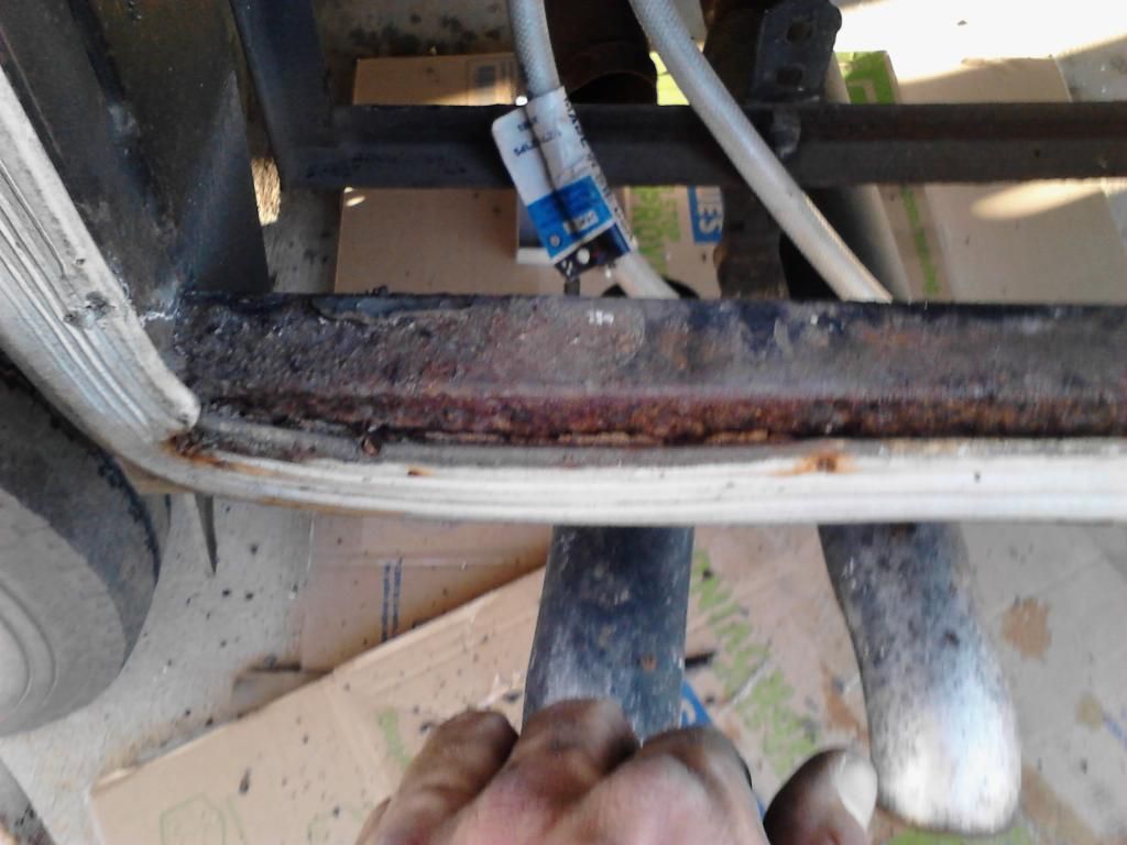

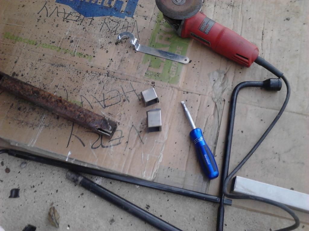

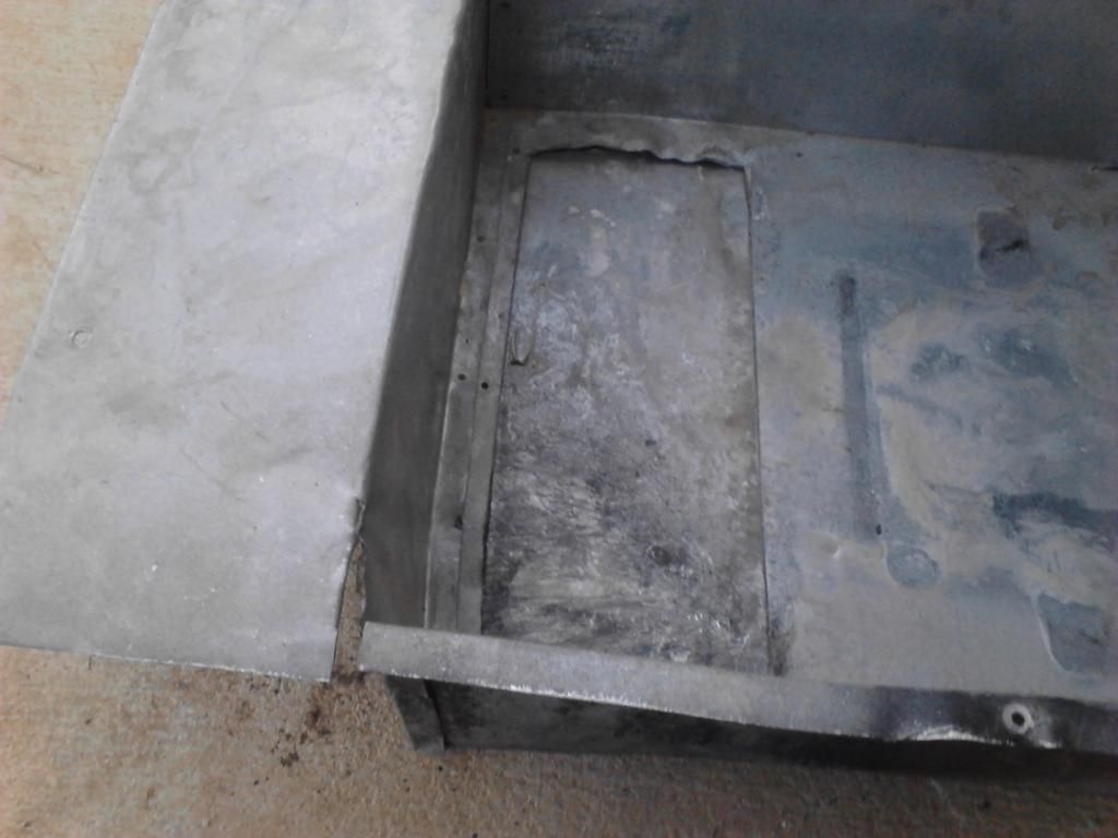

I repaired damaged metal around the water heater's compartment.

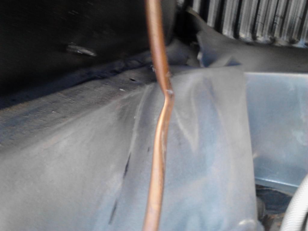

The previous owner had a blow out and did a lot of damage. The RV is missing a storage compartment, the wheel well fender is loose, the water heater compartment was damaged which crimped the gas line allowing no gas to pass; and the black water tank damaged. I fixed the black water tank with some silicone and new pipe that allows you to flush the tank. I haven't got to the storage compartment yet.

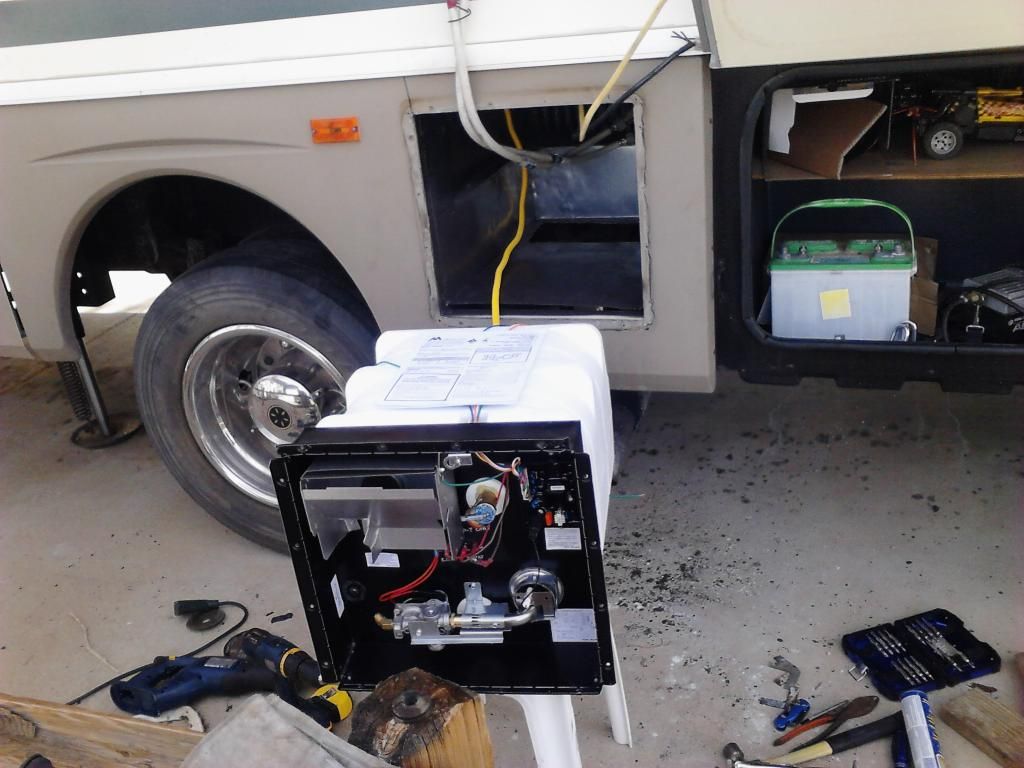

Here are some pics of my water heater replacement:

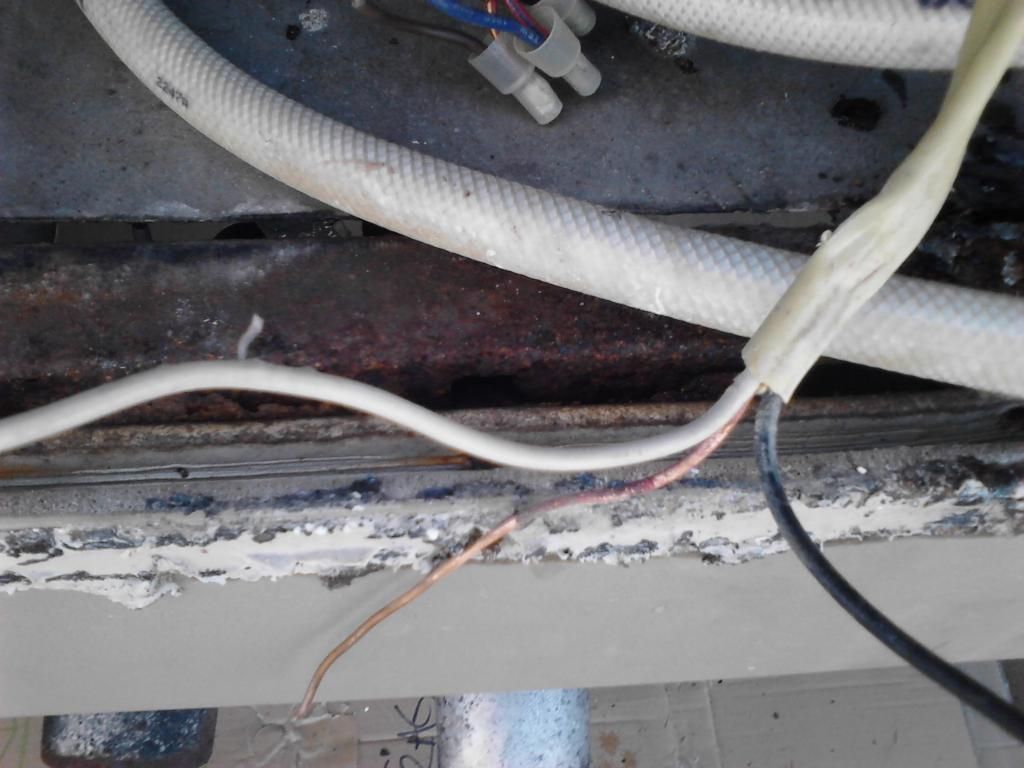

  • I'm confused on the rat nest...???
    Haha, the water heater door hides that messy job. ;)
    There is a crack in the fender which I used caulking to seal it. I should have used clear but on hand all I had was white. I haven't done it yet but I plan to cut and peel the excess caulking off. Once I do that I will take pics and post them. :)
    Take Note: the new 10 gallon water heater acts like a 16 gallon and has a shorter time frame of heating the water. This model has an additional wire to control the electric side of the heater. I had to route a new wire which activates a relay to control the electric side of the heater unlike the old model which used a regular 120 VAC switch.

  • I hope you removed that rat nest and looked for any other sign.
