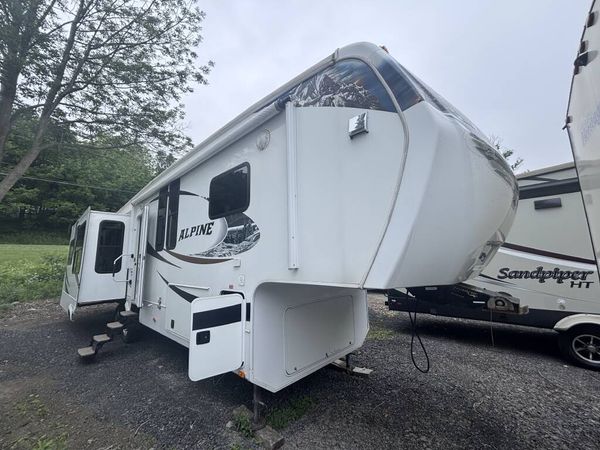

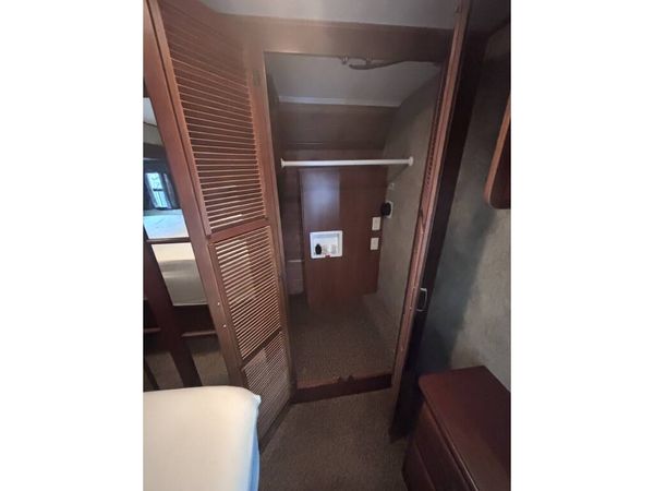

My husband n I have purchased a 2011 keystone alpine 5th wheel that is already prepped for a stackable washer and dryer but we have no idea where the hole for the dryer vent to be placed. Can anyone help by chance? There is no sticker or anything in the closet where the washer n dryer go that says where to make the hole for dryer vent. Thank you for your help

  • There isn't anything on the outside of the 5th wheel for the dryer vent we have to make the hole for it. Everything is already prepped for the washer n dryer to be installed and hooked up but don't know where to make the hoke for the dryer vent to go outside the 5th wheel

      Per the pictures I posted, it shows you where. based on those picture I would think I could nail it, spot on. Find a spot free of studs, cut a hole and install the appropriate vent. It should have all the tape/sealant in the packaging. Easier to do with a hole saw of the right size. Drill it from the inside out until you are completely through, spin fast and push slowly. It's not that hard. You do have an RV specific dryer vent hose right?

  • Sometimes you have to just find a place to drill the hole. Closest proximity to the dryer with a clear shot to the side wall between studs. Maybe if you can find pics on line of the same FW or one close to your floor plan and see where their vent is.
    As an example, I just googled your model and found pics where the vent is located.
