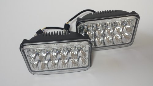

    They may not be street legal.
    I did not see then advertise any DOT of
    NHSA acceptance codes.
  • Few problems I see with that Octane product...
    #1 There's no such thing as an HID LED ... High Intensity Discharge is a gas / arc discharge technology and has nothing to do with light emitting diodes
    #2 Another post for the same product (Octane) claims 50,000 hour lifetime. Cree makes no such claim for their white led products.
    #3 There is hardly enough heatsink to adequately deal with the heat from 45 watts of LEDs - either the wattage is wrong or the product will be short lived. Wattage was specified in the more detailed Octane post.
    BTW Check out DHGATE.com for a better price.
  • i'm looking at these
    LED Headlights
    to replace our headlights
    we have four on the Safari
    i'm thinking one pair to start, replace the high beams
