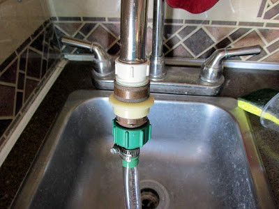

This solution is so simple, crude, and obvious that I am almost ashamed to post pictures of it -- but here we go anyway. This is the end that screws onto the faucet – I have included a swivel fitting to make it easier to attach:

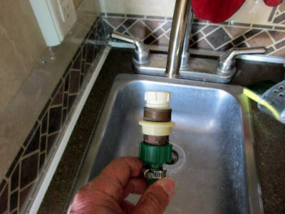

Here it is attached to the faucet:

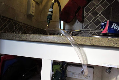

The hose runs over the edge of the sink, under the counter, and into the opening for the outdoor shower:

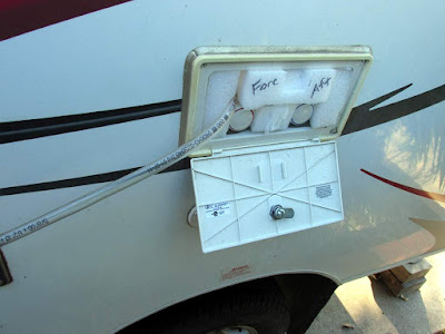

This is an exterior view, showing the hose emerging from the outdoor shower opening – as you can see, I have also inserted blocks of tightly-fitting closed-cell foam blocks into the outdoor shower fixture as extra insulation:
And here is the hose going into the external fill pipe door:
