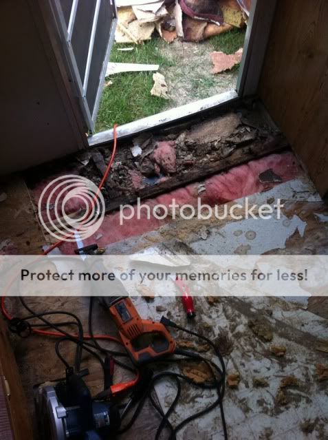

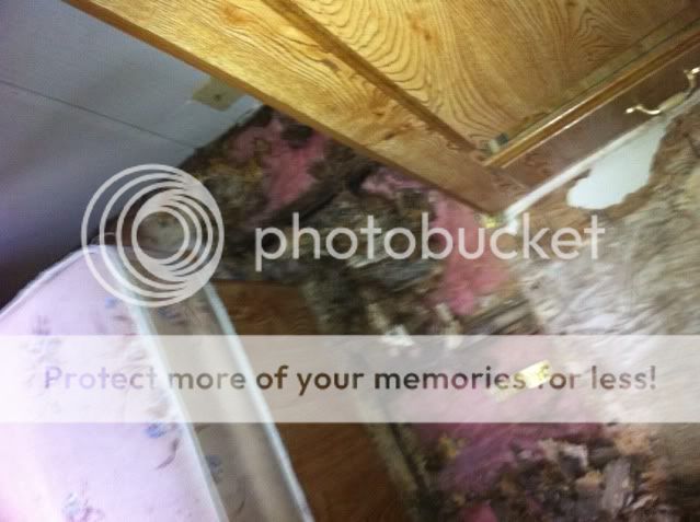

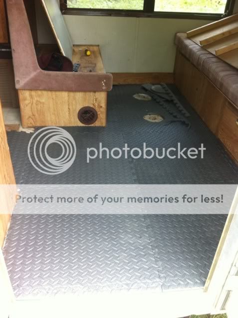

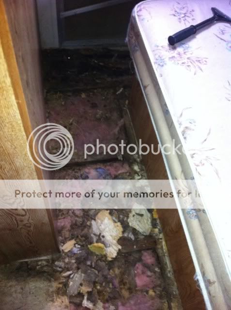

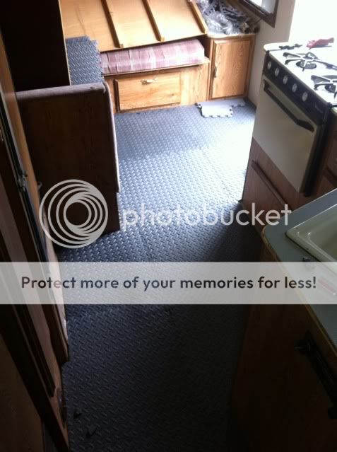

I bought a TT with some pretty good amounts of water damage to the floor, well I added plenty of bracing, cut out the bad spots, laid new OSB in there and finally decided on the flooring. I wanted something fairly easy to clean, easy to install, fairly inexpensive. I stopped at Home Depot to see what they had, and found this! Foam rubber interlocking squares. It may not be conventional, or the prettiest, but I have 2 dogs that are hard on everything, carpet was out, didn't feel the whole linoleum thing, the best part is that if a square gets ruined, I can pop it out and replace it with a brand spanking new one in 30 seconds. It's not glued down or anything, just trimmed fairly tight to the edges. Check it out!
After old wood removal
And with the new flooring!
You may notice a raised square in the middle of the floor, I was in a hurry to head out camping and was tired of messing with it. It's flat now.
