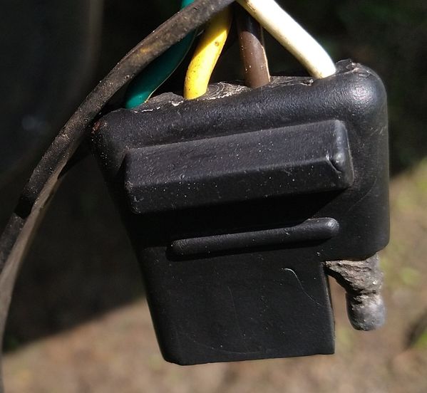

cut it off and splice a new one on is the easiest
- opnspacesNavigator III
I would just replace it
- Grit_dogTrailblazer
If it’s old dielectric grease, use a solvent.
If it’s electrical corrosion soak it in Coca Cola.
Or spend $6.99 on a new plug and 4 heat shrink butt connectors and put a new plug on the end.
