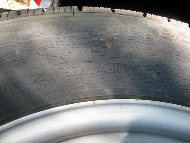

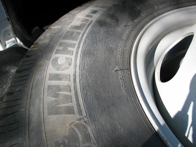

- wandering1ExplorerSo if you think they are dry rotting why don't you go to a tire dealer and ask them to inspect your tires? All the tire expert wannabes aren't going to be able to tell you by looking at the pictures.:S
- MdMike1007ExplorerLook for the 4 digit date code (on my tires it is 1610) which means they were made in the 16th week of 2010. The camper was made in early 2011. I am replacing my tires tomorrow before our weekend trip. They show no dry rot, but ozone and heat can cause the glue that holds the tread to the sidewalls to separate, leading to a major failure.

If they are 3-4 years old replace them! - racedrvrExplorerI had the same experience with the Michelins on my 2011 Chevy Dually. The 6 tires on the vehicle had very minor checking, but the spare was bad. The local Michelin dealer had a template with pictures of various degrees of checking. Mine matched the one which said to replace the tire. They did so for free without question. The explanation for my spare being worse is that there are chemicals in the rubber which when "worked" by usage stretch the rubber and keep the anti-aging chemicals active. My spare left sitting motionless was worse than the other 6.
- FastEagleExplorerWhen exploring other forums about tires you will find that Michelin LT tires often suffer early weather and/or ozone checking. Early on - such as this appears - it’s not a problem. As the cracking widens allowing water to enter into the sidewall fabric or metal material damage will occur. Getting them checked by a Michelin tire center is recommended.
FastEagle - diesel_man_03ExplorerI would not like that tire but you've done what you could, keep that in mind as you are looking for a new set of tires, relax and have a cool one, no sense in having a heart attack.
