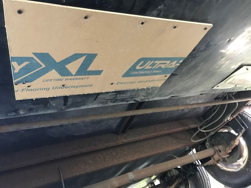

I had the fun task of replacing the Black Water Waste gate this weekend. Here are some pictures.

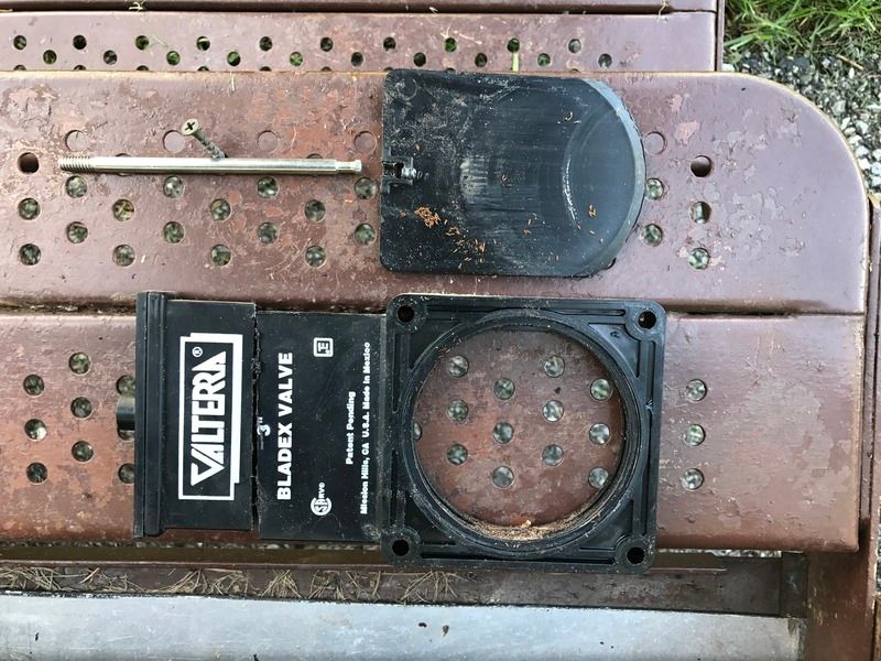

The reason for the replacement was because the Metal Bar pulled out of the blade.

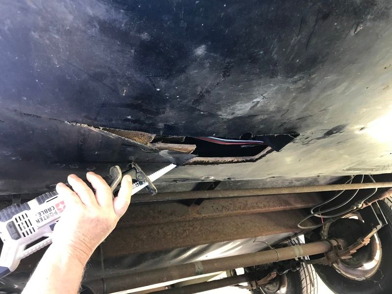

Cutting the hole to get to it.
The Valve itself
Replaced it (sorry forgot the new installed picture) and then cover the hole.

  • Yes it pulled out. But no, not open. We cut the gate where the rod goes in (see first picture) and inserted a screw in to the spot where the rod went. We pulled on the screw with a pair of pliers.
  • UUuuuh, did the rod pull out in the open position? If not, how did you empty the tank?
  • That's a heck of a job.. but a new valve is sooo nice. I guess your mfr thought nobody would own it long enough to have to replace that valve.
  • I removed the bottom on our last TT to install an electric gate valve and found one strap on the fresh water tank unhooked.
  • Well it was that or remove the whole Belly Pan. I opted for cutting it and taking less time.
  • OMG, you had to cut the underbelly of your RV to get to the sewer valves?
