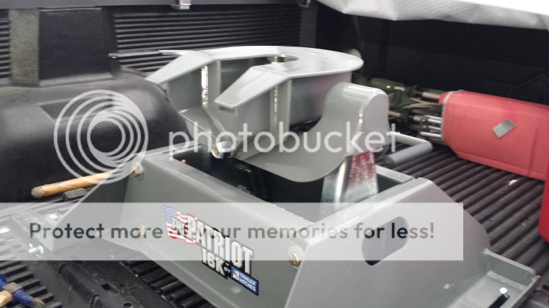

  • I have the B&W Patriot rail based hitch. I can get it out by myself if I take the head off 1st.
    my new to me truck had rails already
