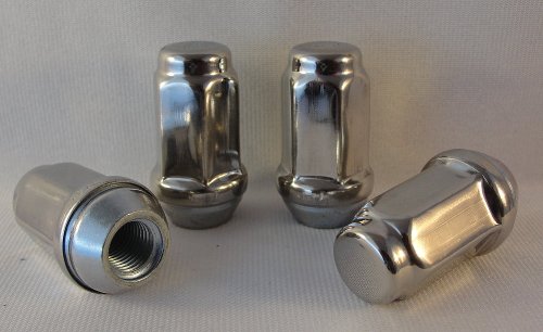

Just re-torqued ours the other day to 120 ft/lbs.
The coach has those darned stainless clad 3\4 nuts.
I goofed up and tried to use a deep 12 point socket and bunged up the nut cap.
Have to remember from now on to only tighten with a six point thick wall socket.
